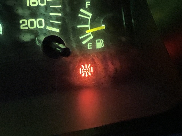

Sadly I don’t have the manual, and this doesn’t appear in and PDF I’ve come across. What does it mean? air filter needs replacing? How do I clear it after I replace the air filter?
I believe it's your air filter warning light.
edit: nevermind. you already knew that. :)
Thank you :)
If that's all it is then all is well, I'm going to hunt down an air filter here somewhere and replace it. Any idea how to reset it?
Most of us Mudders are located in the US, and that light is non-functional in our rigs. So, you might not get a lot of useful replies. Sorry, Google might be your best option.

Right, so as I understand it, that light is measuring the air pressure differential on either side of your air filter. It should go away when you clean/replace the filter. If you want to test, take your air filter out entirely, start the engine, and see if the light goes out. If the sensor isn't faulty, I believe it will.
Disconnect the battery, and try to reset the system when you reconnect? Since you've already replaced the filter.
