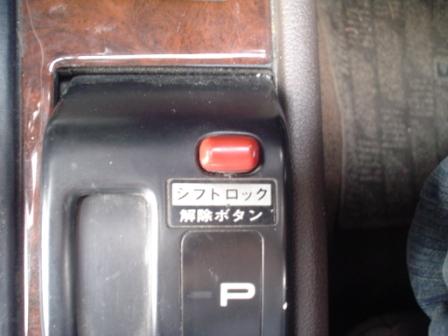

Newbie question:
Anyone know what the red button on the front end of the AT shifter housing do? It's in a '92 HDJ81.
Thanks,
Matt
It releases the lever from the park position when the key is off. The brake pedal does the same thing when the key is on.:)
:)Label says "shifter lock" :)
