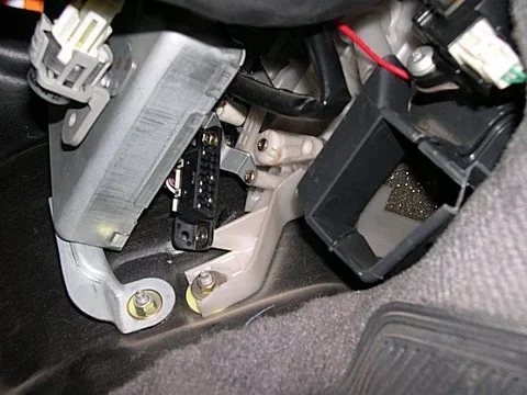

BTW, where is the OBDII connector located? Is it the one that is next to the PS fender in the engine room, right above the antenna? It seems so but it is not the standard connector. It has a completely different pin arrangement.
On US market vehicles, the OBD2 connector is always in the interior, within 3 feet of the driver, but most often in the footwell, near your left shin/knee but sometimes on the transmission side. No special tools to access. The connector on the hood labeled "diagnostic" is not it.

Eureka! Found it! It's over the accelerator pedal, to the right. Very visible once you look up from down there.
I was a bit worried, because I have just bought a scan tool in ebay (yet to arrive), and I was not quite sure that my car had the ODBII connector. What is the other diagnostic connector for?
