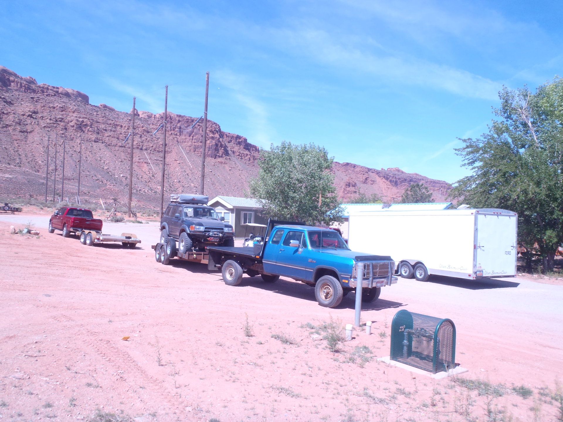

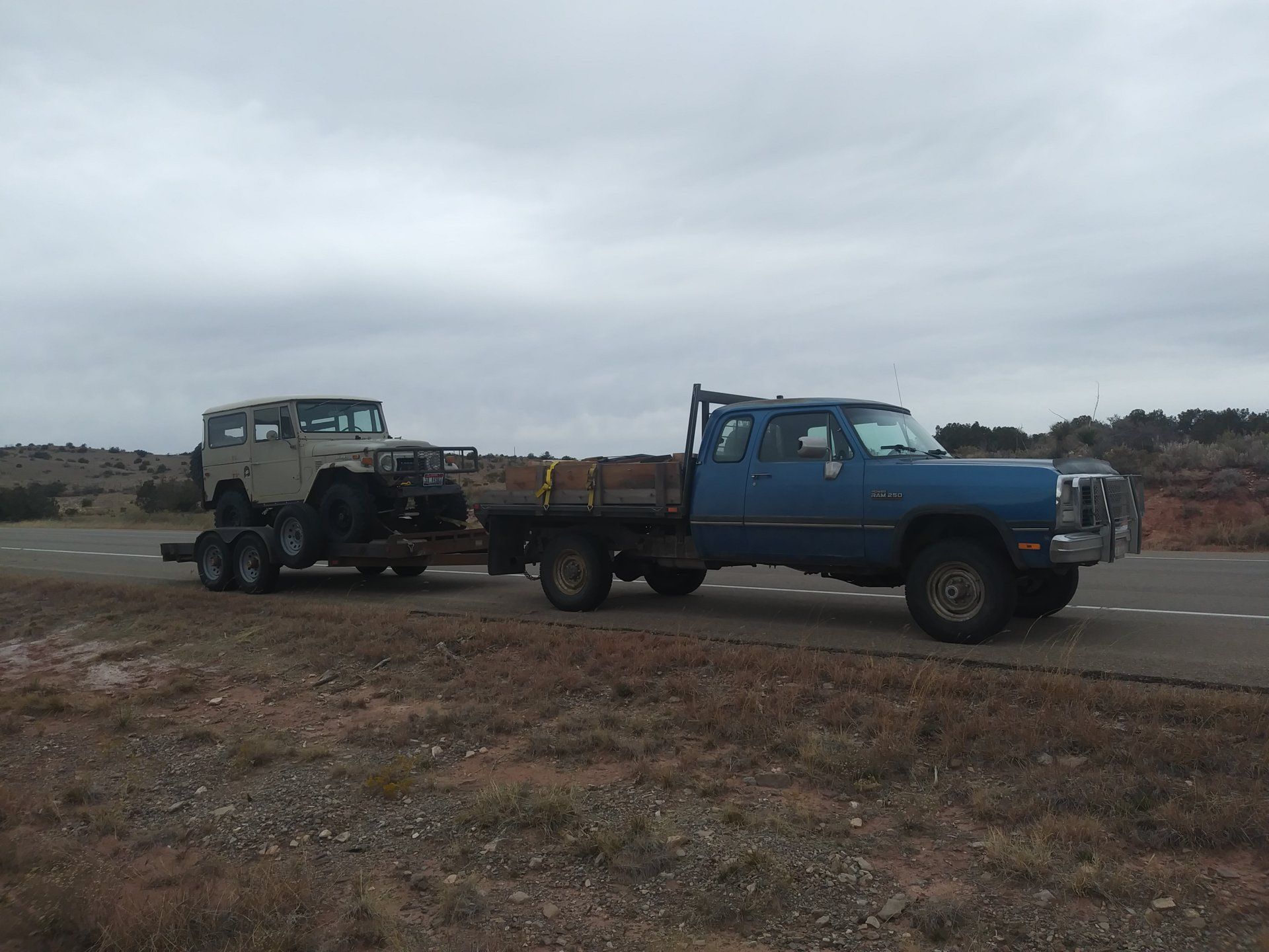

Here is my set up 1993 Dodge W250 with a 16ft Road King trailer. The trailer has 5k axles with brakes and weighs 2100lbs it works just about perfect for me.

Thanks, do you think 14ft would be cutting it too close?
I wouldn't have minded if my trailer was 18-20 ft. on the deck so in my opinion a 14ft would be on the short side.
