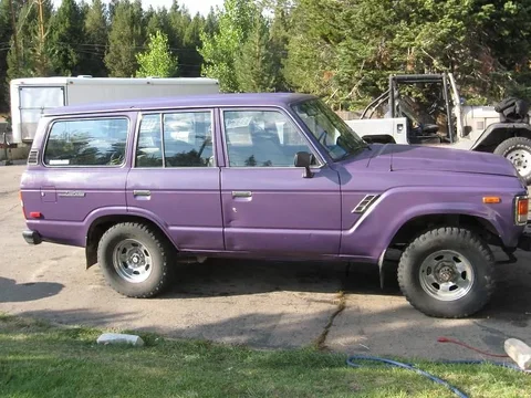

[/quote]that color (colour) is a NO NO :lol:

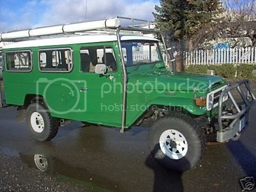

i'll paint mine one day.... probably the 'john deer green" with the battleship grey 16 splits. nothing looks better than stock!

To be honest, I didn't think I liked blue until post #7 and #15. Those look good.
