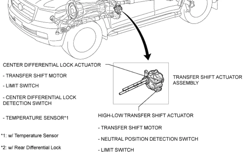

Do you exercise the CDL or 4LO often?
There's probably several slightly different reasons, but I'd chalk it up primarily to electro-mechanical wear and corrosion within the CDL or 4LO actuators.
Almost a year with the fix I did below and it has not reared its head since. With switching confidence and performance improving 100% when off-road.

Sounds like the sticky CDL actuator that a lot of us have experienced. A fluid change plus regular exercise helped mine.

Transfer case fluid change may help if the issue is a sticky actuator. If you don't want to spend the $80/liter for the 75W LF stuff that only Toyota makes, you can use Ravenol 75W available from Amazon for like $20. That's what I use. That said, whether I've had Toyota 75W LF, Amsoil 75W-90, or Ravenol 75W in it I still occasionally get the flashing CDL.
In general when this happens if you drive for a bit and warm up the drivetrain and engine for 5-10 minutes, then turn the truck off and restart it, the light goes away. I think there's either some sort of self-test or more likely some sensor which misreads (e.g. looking for a resistance value of 100-1000 ohms or a specific voltage) at start time at which puts the CDL goes into "duhhhhh" mode when it is outside the expected range. Once it warms up everything reads fine and it'll clear on restart, The actual fix for this is probably what @TeCKis300 did and that's to take apart the actuator motor and clean it. Most likely the contacts in the motor are dirty and so the resistance is too high and so the CDL goes into stupid mode to prevent damage which might be caused if it was repeatedly trying to activate but can't. (just my theory).
It doesn't hurt you to drive with the light flashing. That said while it's flashing you can't engage the CDL nor can you engage 4Lo.
