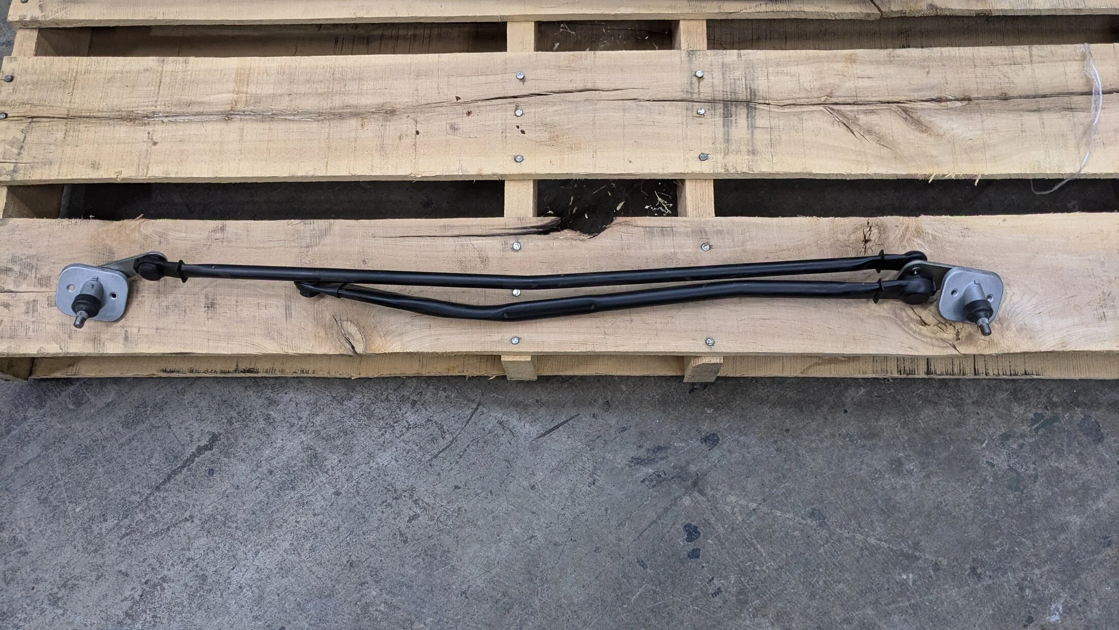

The 60 series wiper linkage seems to be NLA worldwide. What are people doing nowadays to fix bushings and what not on these? I was looking at the 80 series linkage and it looks kinda similar. Wondering if it could be adapted to work on the 60

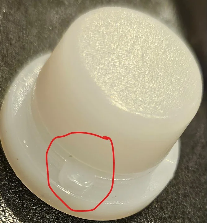

A company in Australia was making a nylon insert but from what I can see, NLA. Didn't seem to hold up to well from a few comments I read.

I cut the ends off of my linkage arms and welded in nuts so small heim joints from a motorcycle shift linkage could thread into the ends, then welded a bolt in place of each of the pivot balls, and put it back together. It took a few tries to get it all adjusted right but it's been good for a couple of years and about 20k miles now.
