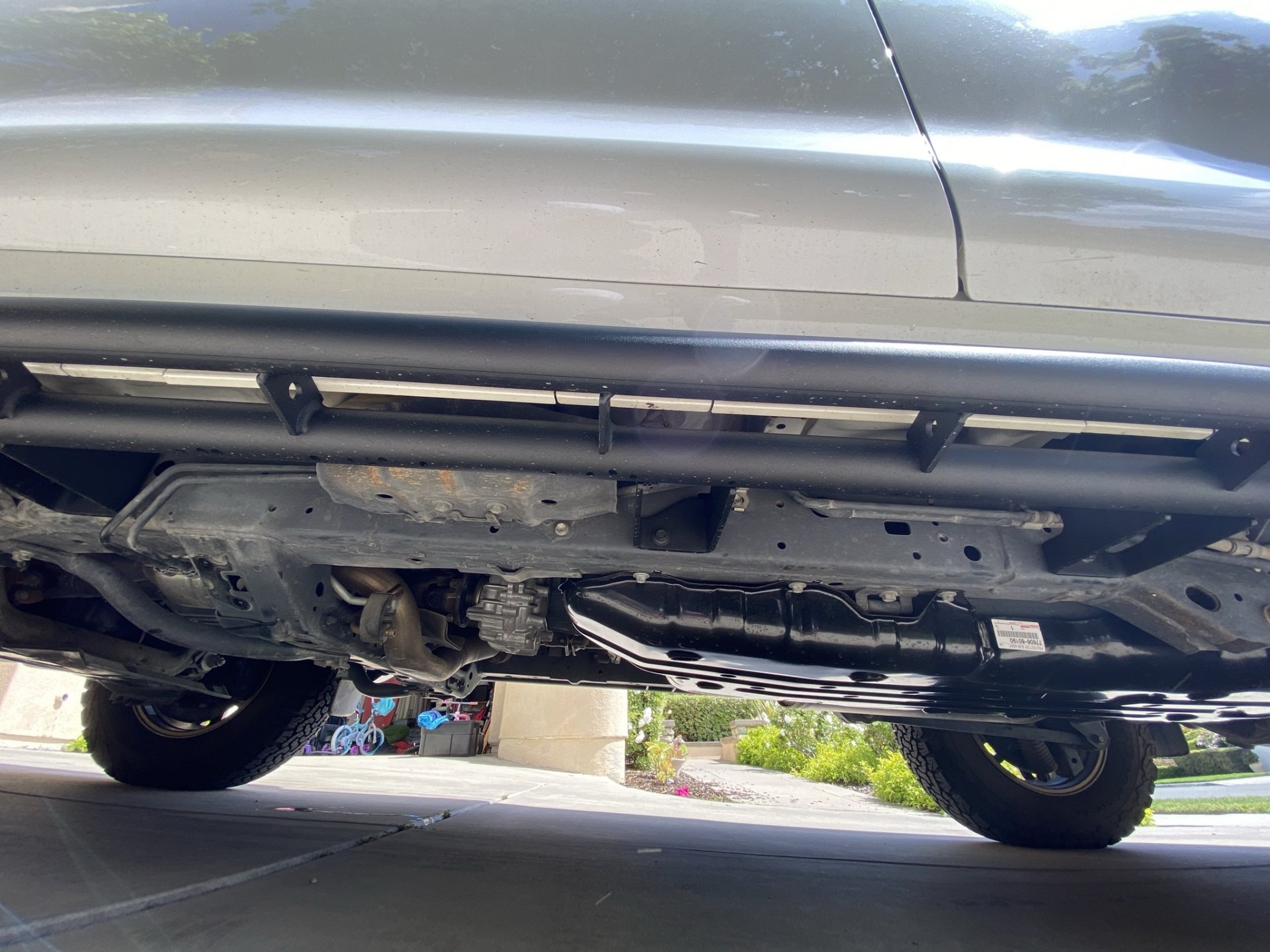

I'm not sure about the question about the front gap. As you see in my pictures there is no gap between the slide and the prado side skirts. Without the prado skirts the distance to the back of the front tire is probably 7-10 inches.
You cannot use it as a step with the prado side skirt. That is probably also true of the GX460 skirt that is cut. Maybe without a skirt you could fit a foot in there but then the bottom of the car looks unfinished.
I have All-Pro sliders on my GX470, although they are actually a 5th gen T4R slider and therefore should fit a 460 (I had to do some drilling to put them on my 470 - you shouldn't need to). They have a kickout and work with KDSS. You will have to cut the skirts but that is easy with a dremel. They look great and function great as a step for my family. They are around 50 lbs per side and plenty beefy, but overly so. Despite my GX being stock height and wheeling in CO, UT, and around here, I have yet to whack them with anything....IMO you'll need to be doing some pretty hard wheeling or not pick the best wheel placement to actually hit a slider. As others have mentioned they are a great insurance policy though and on of the best mods that can be made for access into the vehicle and aesthetics.

1. Got prado side skirts
2. Toyota 4Runner sliders
3. Lifted 2 inches front and rear with Bilsteins
4. 17 inch trd rims
5. Bfg ko2 255 load range c tires. I think they are 32.1 inches tall but a bit skinnier than stock.
Made a beautiful package.
