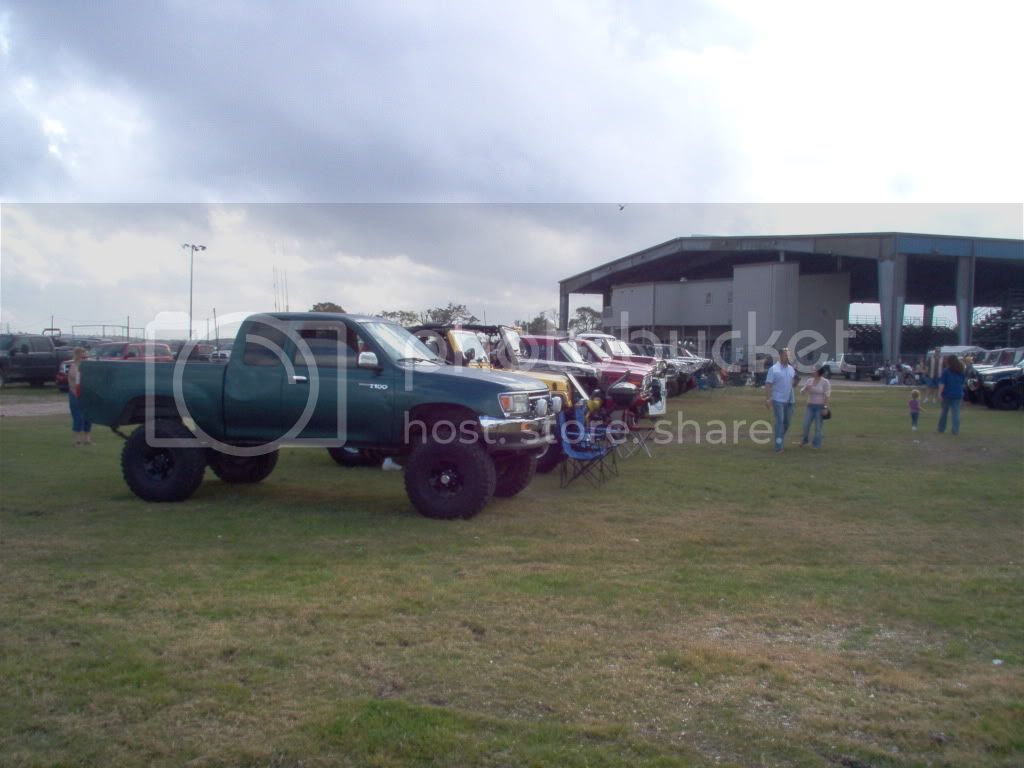

would like some bolt on sliders and a winch bumper....
click it>>>>>>SaS ...Here we go... - TTORA Forum
Thanks, jomentum.
Great links. Good info. Looks like I can anticipate a R&R of the flexplate as a PM if it is an auto. THEN I can put the goodies on it .
Would love to do the SAS trick too.
