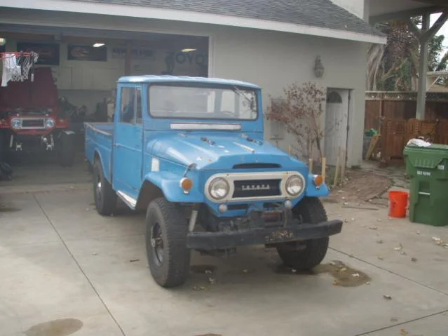

Just returned the the "Bureau of Automotive Repair" here in good ol' California. Wanted to get the facts on converting my 65 FJ-45 over to diesel. First the motor has to be the same year or newer and it has to have been offered as an original power option??? I know they came with the "H" diesel, but was that an option in the US? After I finished talking to the gentleman he said " it's a 65 and smog exempt" who will know!! Now I am totally confused. I have heard some horror stories of guys not be able to register their vehicles here in California. Anyone had any experiences?:confused:
Thanks
Mike
Thanks
Mike

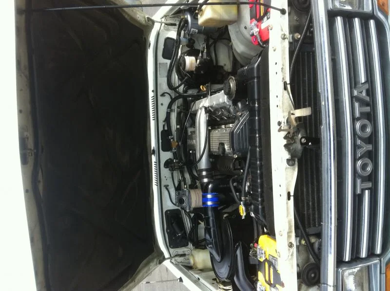

I put a cummins 4bta in my 94 80 series and got it registered in California no problemo. Good bye smog checks, hello biodiesel.
(It'll be for sale soon, too!)
