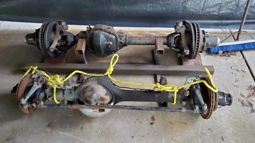

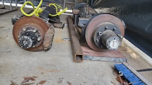

Never knew that Ford 8 lug was different than Chevy 8 lug, but I found out today!!! Tired to fit my newly acquired rims, on my front axle today. Good thing I did, before getting new tires mounted. Then I did some research, and found that ford likes a 170 cm diameter, and Chevy likes the 6.5" (160.1 cm).
So, now I have a set of Ford 8 lug rims, anybody want to trade for some Chevy 8 lug?
Otherwise I will now be on the hunt for a set of 4 8 lug, 16" rims, to fit my Chevy axle.

New front axle, I got lucky and found a Dana 60, already shortened for the Land Cruiser. now just getting it ready to go back in
No more Birfields , Big Boy
