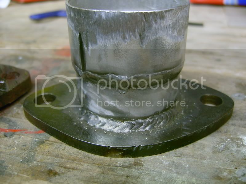

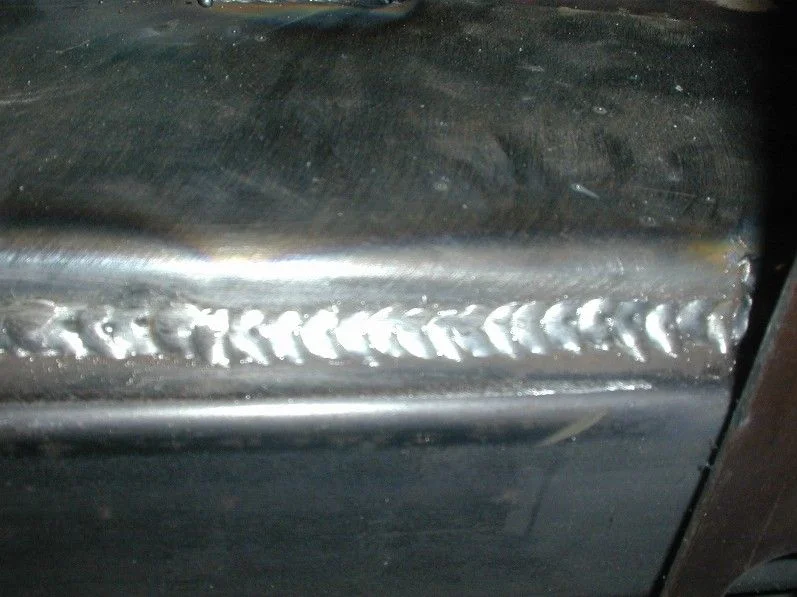

Here are two pics that show what I am talking about. I don't think this type of interrupted welding is appropriate or strong on structural welds like cages, but is a great technique for sheet metal (I see it on cages all of the time - opinions on this ?). Same thing goes for vertical down welds, not safe on structural plate, but ok for sheet metal 11g or thinner.
