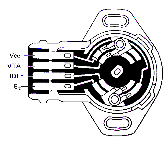

My next guess is the TPS...
For some reason, I want to say it is throttle position to power related... Because of this pic...
http://www.4crawler.com/4x4/CheapTricks/TPS/index.shtml
Tps or the MAS, The MAS is famous for wearing out from lots of the same throttle areas being used, u can cut teh seal and take off the top of the MAS and try and see if the circuit board is worn
