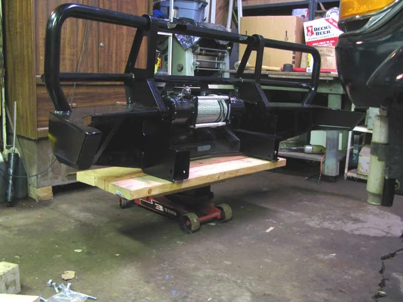

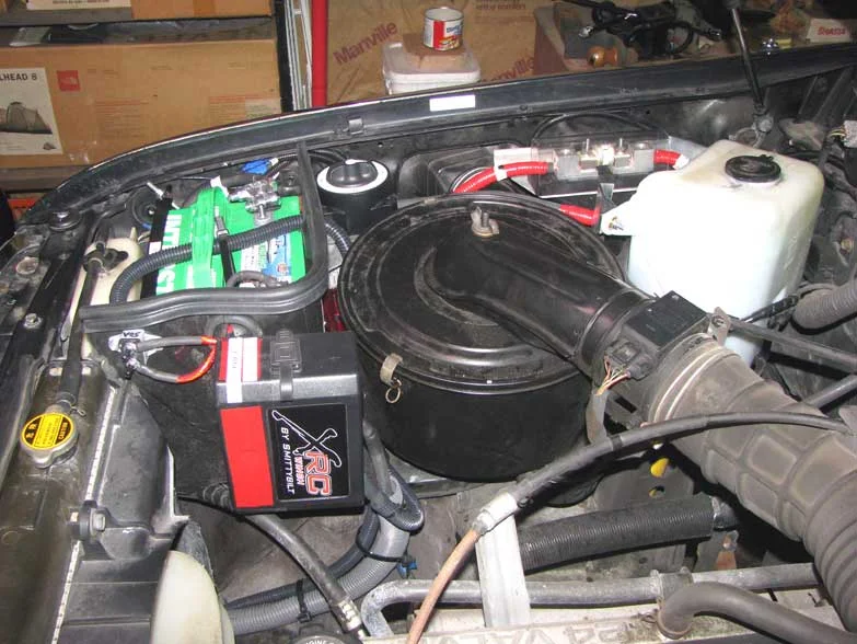

Was re-reading this post and I realize I neglected to get back with the install pics, so owed Brian a few since he asked. :o
better late than never, I suppose...:p
These are a couple years old and there's plenty more if anyone has any questions about the install.
