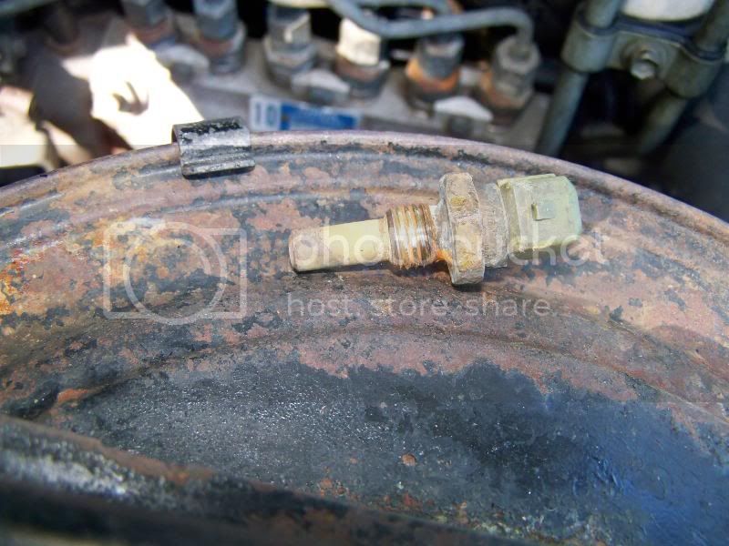

The later 2H with the super glow system has a water temperature sensor in that plug.
Use a maf torch/ oxy, etc or similar to heat it up as it will be held tight by rust maybe some bolt off or penetrating oil.
Trusty rattle gun will shift it for sure.:cool:
If I get a chance later today I will pull my sensor out and tell you how much depth there is.:D

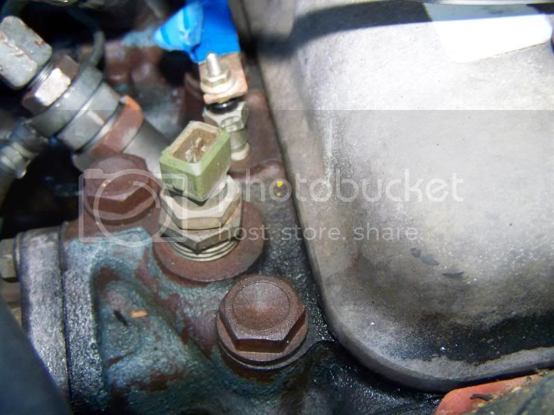

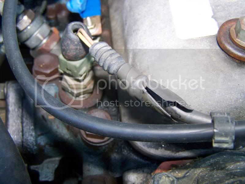

My 2H has that water temp sensor in that hole you mention. I also mentioned that waaay back when I first started this thread!!
My question now is where else can I put the sensor for my water temp gauge????
Were the temp readings accurate even though the probe was only partially in the coolant flow? I only ask because another member thought that would create a misreading.
I am not with you, the sensor is fully in the water in the head. The probe part is app 28 to 30 mm [1 1/8" to 1 1/4''] long and all of it is in the water. This sensor reads the temperature for the[ super glow] glowplug system. :idea: If you are worried about accuracy connect your mechanical gauge up and put the end into hot water then fully submerge it then tell us the difference, ;)
Why not put it under the thermostat where the original POS was fitted?
The reason I don't put it in the original temp sensor location is because I need an adapter to go from whatever thread/pitch the hole is to whatever the thread/pitch my Auto Meter electric water temp sensor is.
This goes again back to my original (first) post in this thread.....!!
I have no idea by looking at the hole what size adapter with what threading I need for an adapter. That's why I asked if anyone knew what size/thread the original hole is.....
