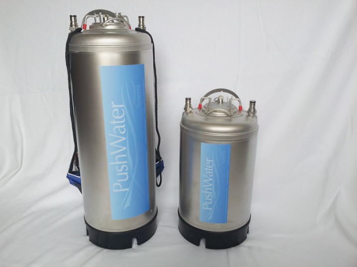

So I've been thinking about water and how to make it convenient to carry. The issue i have had has been jugs that leak, Cans that are hard to pour, Containers that are hard to clean and water that is hard to filter or use. Over the last few months i have been messing around with a system that uses compressed air to push the water out of a sealed stainless steel container - actually a beverage keg. At first i used these mainly as a way to spray off after i mt. bike but i soon started to mess around with filters, and drinking water and found that it works great for camping. These things are easy to carry, use and are indestructible. I use a bike pump to pump mine up but you can also use CO2 or onboard air. I'm working on a few other attachments like a shower and a hand washing setup. I have a few other ideas as well concerning stringing multiple up for more capacity. I wanted to be sure that the drinking water was safe so every part that touches water is of beverage industry quality and NSF certified. So far it is working really well with some minor tweaks here and there. I’m working on a 3 and a 5 gallon system. The 3 is good for a car and spraying off dog paws or legs after a ride. The 5 is good for camping and longer trips with more people. My kids and i used a 5 gallon for a camping trip over the weekend and it was perfect. Nothing like having running water in your campsite!

How tall and what diameter are these?

The tanks are 8.6" dia. the short on is about 16" high and the tall one is about 24" high.
as far as pressure if you pump them up to 100PSI they will push most of the water (depending on how much room you start with for the air.) For drinking water the limit is about 20-30 PSI and you would need to refill the air part of the way. You could also hook them up to onboard air or CO2 (although the later would carbonate the water. One option is to get both a 3 gallon and a 5 gallon and pump the 3 gallon with air to push all the water from the 5. These can also be daisychained or attached together for a continous supply of pressurized water.
I'm still working on pricing. The tanks are made in italy - so really high quality stainless steel - the majority of the parts(with the exception of the plastic spray head and the italian tank) are made in the US.
A full 5 gallon set up weighs 10 lbs and a 5 gallon weighs 8lbs...so pretty light too.
