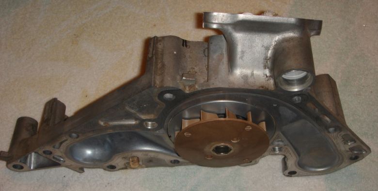

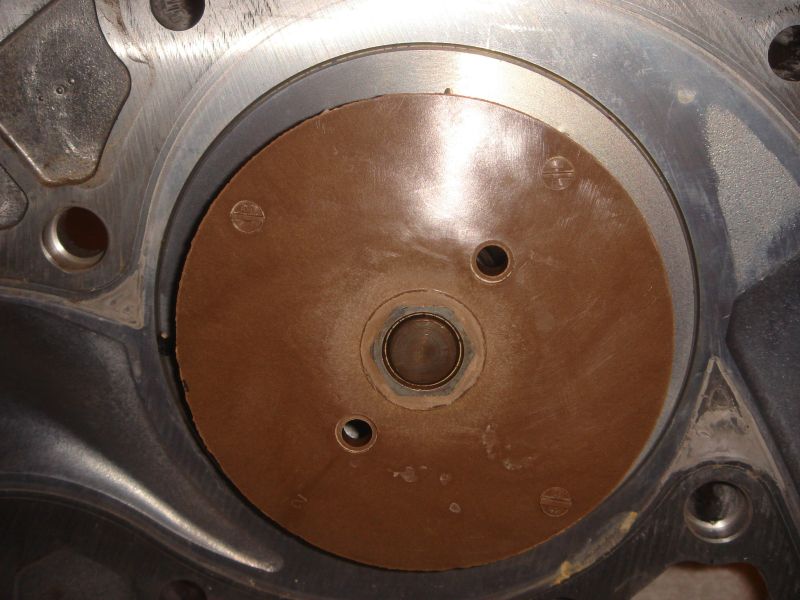

The original pump from my '00 LC 100 has a plastic impeller. The new replacement pump from Toyota is also plastic. You can see that the plastic impeller is molded to an intermediate brass hex sleeve which I assume is press fit to the steel shaft. As long as no stray chunks get ground thru the vanes and as long as the engine doesn't get severely overheated for other reasons, I don't think the plastic impeller will ever become a problem. Numerous manufacturers are going this route.

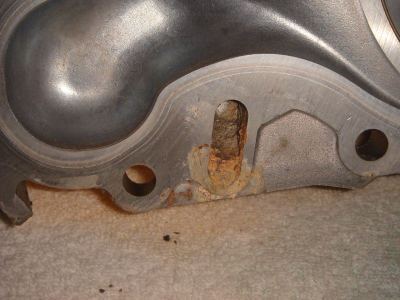

The weep hole goes from the front seal to the back of the pump. Mine would drip approx. 1-2 teaspoons of coolant overnight when temps got into the 20's or lower in the winter, not enough to be a big concern yet enough to have to check the level every week or so. It hasn't dripped at all since I put the new pump on. A few pic's:

thanks for the pics! well I am a bit surprised that the impeller is plastic. you are right, it is more and more common.
I hear of oem plastic impellers blowing and f-ing everything up..at which time they buy metal impeller pumps (never heard of this happening in LC's tho).
I certainly don't think it's something to worry about but it is just slightly disappointing to see it's a "regular pump" instead of some super-duper LC "rebuild it and last forever" pump :grinpimp:

Pic's of the water pump have 100k original miles on it. It had a fresh change with Toyota Long-Life red stuff at 31k miles in May, '03; doubt they used distilled water. I collected most of what drained out at 100k in Jan '06 when I did the timing belt. I topped it off with 50/50 new Toyota Long-Life and distilled water. It's due for new hoses in the spring and I'll discard the old coolant & flush it & use a 50/50 mix of Toyota Long-Life & distilled water at that time. That should tide me over until 200k when the t-belt is due again. Just for grins I'll take the right cover off at 190k & do a visual on the belt to make sure it looks like it will make it to 200k.

If you had reported changing every 30k with 60/40 mix of coolant & distilled water, I would have started to worry about my pump.
(The pic of your pump weep hole discharge shows evidence of corrosion scale.)
