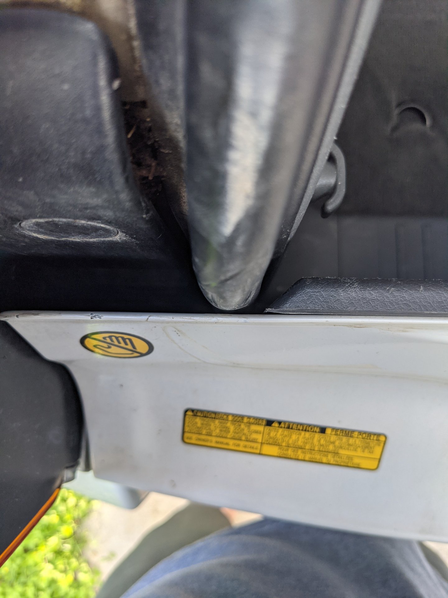

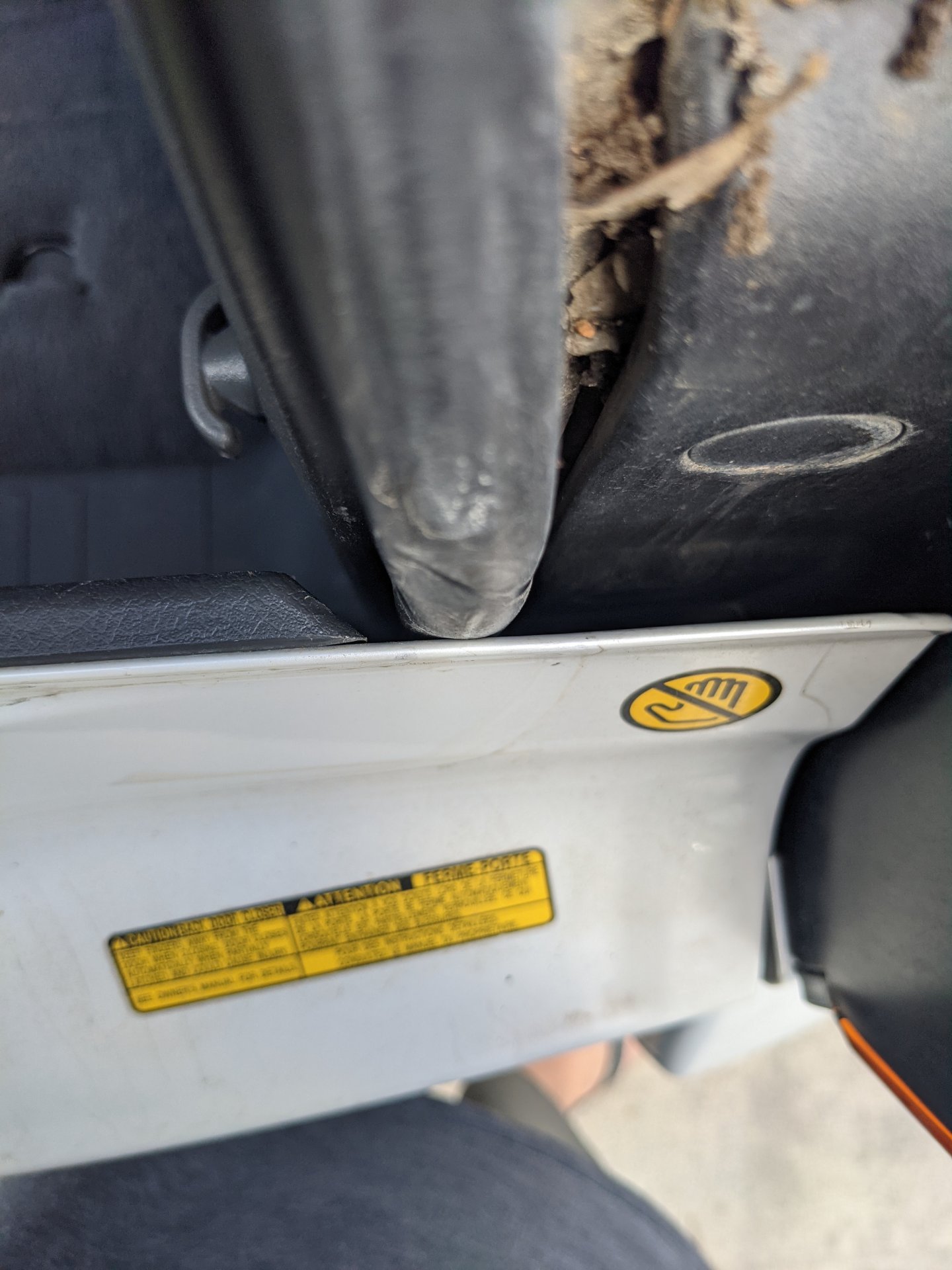

Noticed last night after a movie (got some heavy ass rainfall out of the blue) that my windows were foggy. Go check the truck a little less than a day later, definite water smell. Leak is isolated to the third row area. Passengers side is dry, drivers side is a little moist on top, with most of the water coming from the padding underneath the carpet. The headliner is dry, so I don't think it's the roof rack seals. Noticed with the lower tailgate up that it doesn't form a seal on the drivers side like it does the passengers side. Thinking of adjusting the striker to get a better seal, anyone deal with this?

Water is definitely coming in from there. I actually have a feeling the seal is fine (applied some shin etsu) and the tailgate is slightly tweaked from one of my big ass friends sitting on it (or maybe just years of wear...). Oddly found a post from you years ago, gonna try that out to get it to seal again.

Tailgate cable anchor is problematic for sure. Also the general shape of the hatch that can be tweaked. Its a recurring issue. Just never had a leak from it. I replaced my seal because of dust making its way inside.
Also the latch bars that determine how tight the tailgate sits.

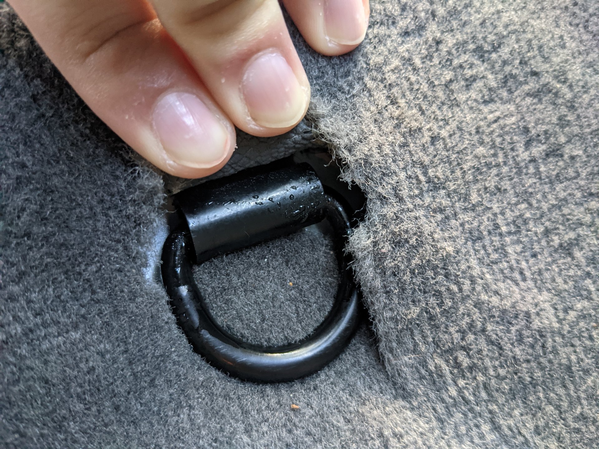

Drove in heavy rain today and let it sit outside in it. Went looking for the culprit — figured out girls left food somewhere. Climbed in the hatch and lifted the rear mat, and there was a little condensation on the underside of it. Went back and touched the carpet and it was very wet and really smelled, so I started pulling it out right then. That’s when I found the mold.
Photos attached. The most soaked parts were closest to the hatch. There’s a lot of mold on the backing of the carpet and on the jute padding underneath, and some on the floor pan too.
