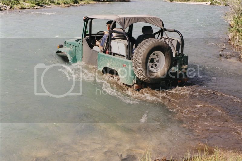

This creek is about 4 1/2 feet deep in the middle. Cross facing slightly down stream and keep your speed steady but slowish. And don't touch the clutch.

Your kidding right? This pic doesn't show a water crossing, this is basically a puddle compared to what people with snorkels cross. Your engine is not even submurged, of course you don't need a snorkel for that. An 4x4 could cross that, possibly even a 2 wheel drive truck. The fact is if you want to cross water that will reach over your hood you need a snorkel, period.

Can't you read?
I said 4 1/2 feet.
Any deeper and I would take off the fan belt before crossing. And yes, I've had water over the hood and the stock intake did not drown. Its seems to hide in that little pocket up near the hood.
Any deeper than that and we find another crossing, because the current pushes you around.
The fact is, most snorkets are for looks. Unless you have a diesel cruiser. Gas motors drown to easy.

Not true, if the gas motor has a sealed dizzy, with grease on the plugs, and good plug wires, it will have no problem crossing water, not as good as a diesel, but it'll get the job done.
That pic is of a proper water crossing, not the deepest water ever crossed by any cruiser.
It was taken 1500km's from my house. I drove my 40 there, just like it is pictured (no hard top) on 37 inch tires.
The only trailer I used was the 3500lb tent trailer I pulled with the 40.
The trail we were on is a couple hundred km's in length.
Why would I want to drown my 40 in a situation like that?
The point is, if you cross properly, and use you head, you don't need a snorkel for expedition type wheeling.

There are way way way more things that need to be done to do repeated water crossings with out causing damage to your rig, besides just slapping on a snorkle.
You have to run breathers on everything and I mean "everything" fuel pumps, Alts, coil, igniter,dizzys, starters, etc etc. And half of those wont require a breather but some other form of water protection. To do it right and for a rig to be able to with stand deep water and multi-crossings of streams everytime out.
Now I am not saying a normal rig can't be dunked every blue moon with out causing problems. I am just saying if you plan on playing in the water a lot there are things you need to do to keep your rig running right.
I suggest you read up with what the Alaska crew are up to because I swear half of those rigs should have props out the back of them...
How long do your TTs go back? ...Plenty of atricles from him on water crossings.
Mark would know why the water is the pic is that funny blue/green color.
The pic was taken in the Canadian Rockies and it is glacial melt water. Super cold, no swimming here.
