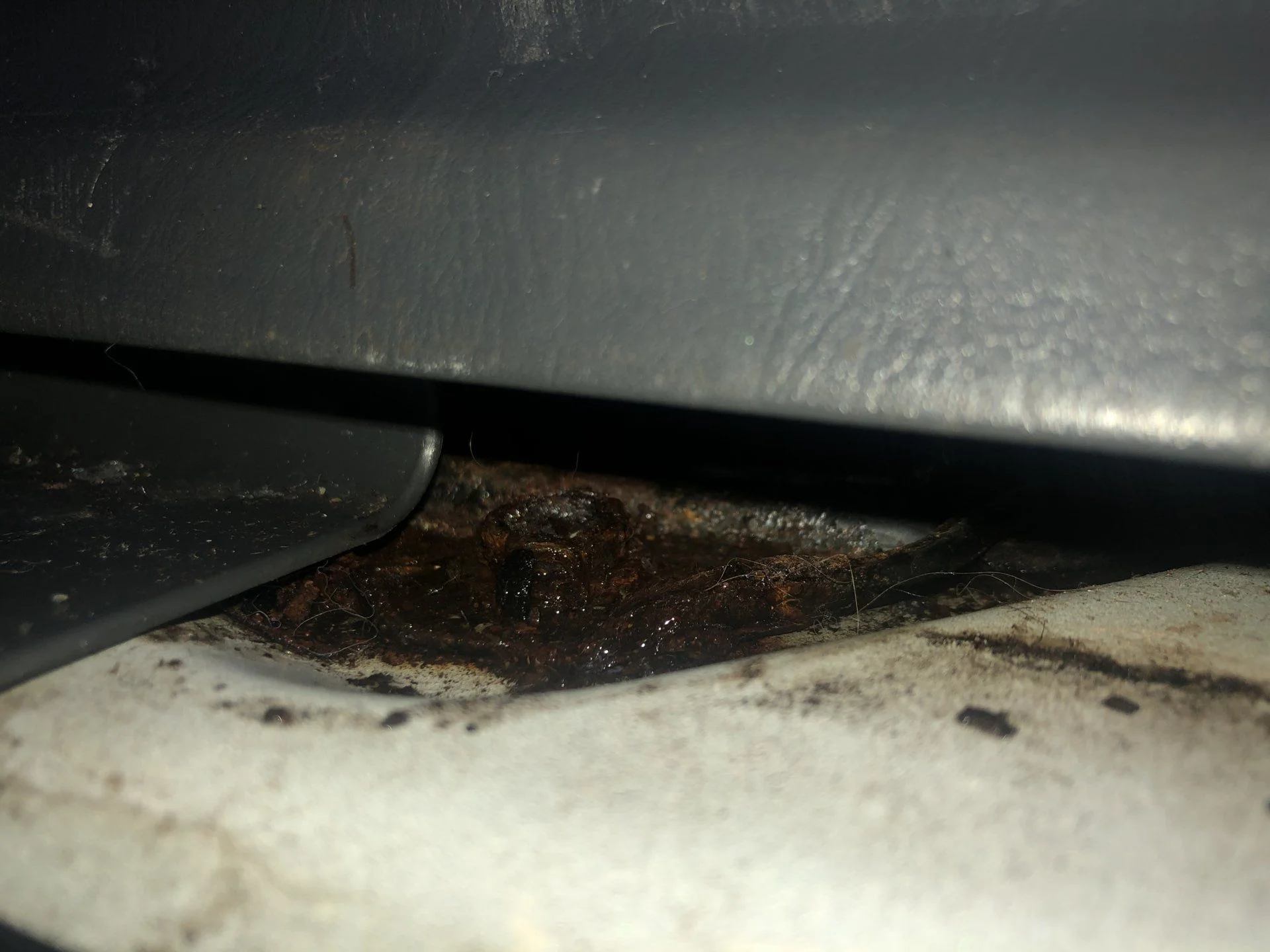

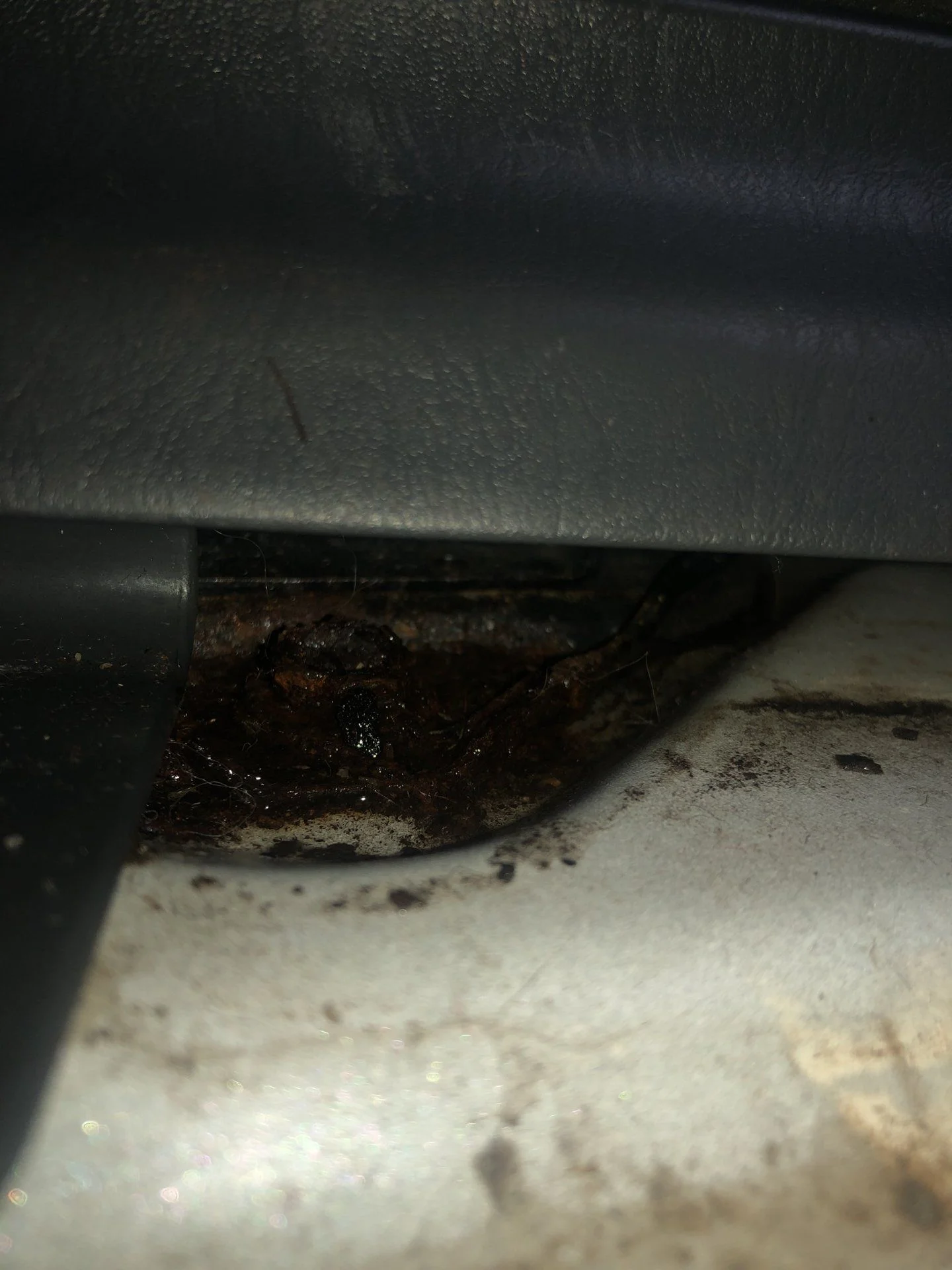

however, I noticed some water pooling below the plastic trim, on the right side of the cargo bay.

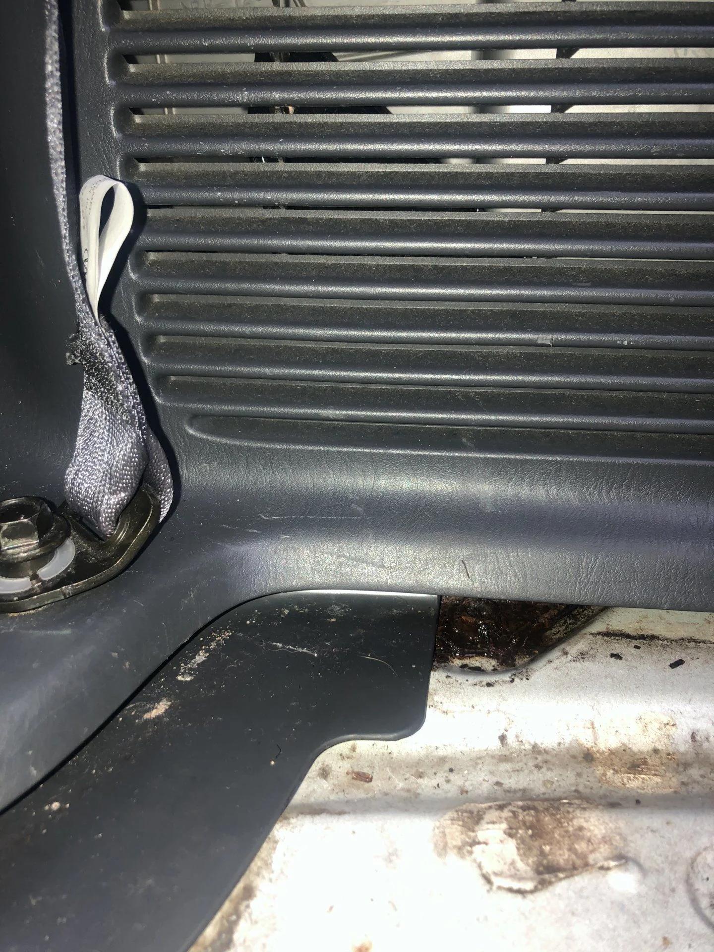

I can’t pull the trim because the bolt for the seatbelt won’t budge - it actually ripped my 10mm socket.
anyone know what that bolt is / have thoughts about how it could be so wet? From the looks of that rust, water has been in there for a while.
Any suggestions on removing the bolt that holds the seatbelt in place?
Harbor Freight sells this stripped bolt remover that I have had some success with...although my bolt wasn't rusted like yours!
You probably need to soak with PB blaster and will need to heat it up with a torch, although that area doesn't seem to allow you much room. hmmm
^^^^^ that^^^^^ then order the new trim pieces for the quarter windows. They dry rot and then leak. Fairly easy repair.

any thoughts on how to get the seatbelt bolt out? left side of the last picture. I can’t pull the interior trim panel off without removing that bolt.
once it’s off, I’ve got much better access to the rusted out bolt and can try to see where the water is coming in. Hopefully it is just rotted out trim for the quarter window. watched the video on here before about replacing that trim, and it didn’t seem too bad.

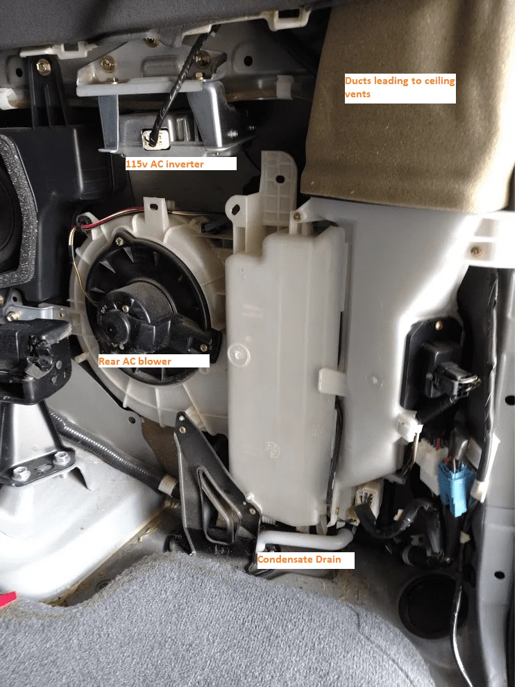

Hm, so I found these shots from where someone pulled the trim panel off the right side in the cargo area.
I'm wondering if one of the AC parts back there could be leaking? The bracket that is all rusted out is the one beneath the condensate drain.
Once you get in there (under the panels) it will be fairly obvious. Use PB blaster, heat, and tapping to get your rusted bolt off. I couldn’t see how bad the bolt is but sometimes I’ve gotten lucky with a very very tight vice grip and a bar, if the bolt is already rounded off.
My seatbelt bolts came off easily. If yours isn’t rounded off already, get a hefty 6 sided socket that isn’t going to break, and get a good wrench and a small pipe or breaker bar if you have to, after soaking with PB blaster and torching it, whack it so it breaks free from the rust. Or if you have power tools, a lot of time those can loosen it more easily because they have torque to twist it off.
Everyone on here has much cooler tools than I do, lol.
You can't see it super clearly in the picture, but the exposed part of the seatbelt anchor bolt has no threading. I'm assuming the part with threading is under the trim?
I've got some pb blaster, and will try to get that bolt pretty good. Will snag a better socket, and use my breaker bar. No torch or power tools that would work here. Worst case, it's going back to the shop on monday so that they can fix the weather stripping. I'm sure they'd pop that bolt off for me.
I think the rusted bolt / bracket near the condensate drain should be alright to get off. When I got my fingers on it, I could feel the bolt head. So it at least still has its shape.
Really curious if the condensate drain is leaking, or if it's the quarter window trim.
If it's the window, I should be able to check by having my girlfriend spray the window with a hose, and I can watch for any leaks, yeah?
Yes the seat belt bolt has a "neck" where it's not threaded. Also, and I don't know for sure on the GX, most seat belt bolts on the floorboard are visible from the undercarriage. see if you can find it, and spray some PB Blaster from that angle. it doesn't look too rounded off so I'd spray some PB Blaster, tighten the bolt (to help get it in the threads), spray PB Blaster from underneath... and try removing it again after letting it sit. I've had to wait as long as 24hrs for the PB blaster to finally allow me to bust loose a undercarriage bolt in the past (on my old Tacoma)

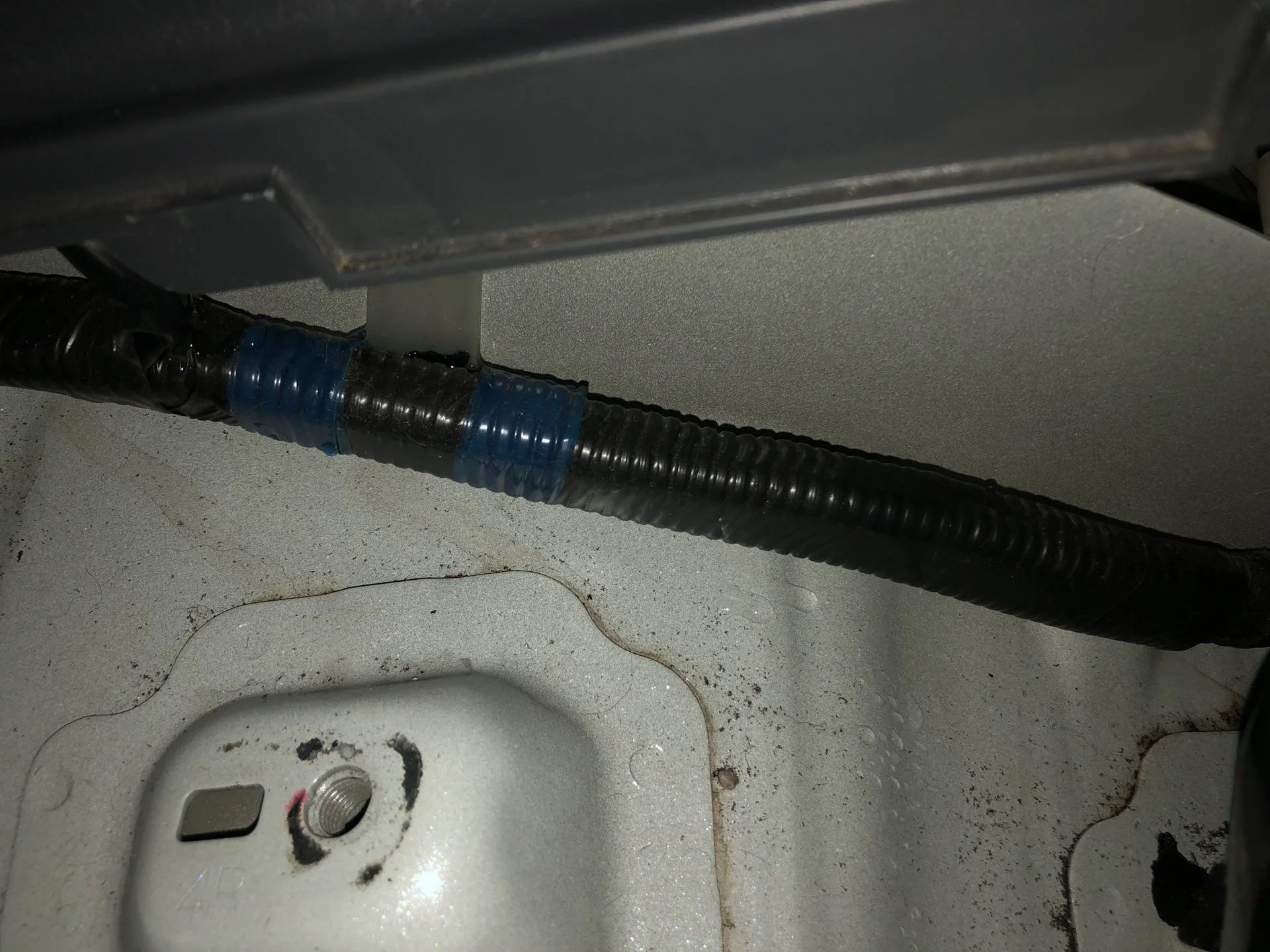

pulled off the bracket where the third row seat attaches. Had my gf pour about a gallon of water along the top of the window where it meets the weather seal. Water immediately began running down the metal inside the car. It ran along the wheel well and the black cable conduit, and right into the basin where the drain is.
fortunately the window doesn’t leak along the weather stripping at all. It just appears to be the chrome moulding piece. The rubber on it is cracked and missing in places. So I’m not totally surprised it’s leaking.

so finally got the seatbelt bolt out? what finally worked for ya?
when you put it back, hit it with a wire brush first, then antisieze. you'll be thankful if you ever have to remove it again.
few sprays of wd-40 from below the car where the bolt stuck out did the trick. Came out easy after that. No debris or rust on the bolt, but I’ll follow those steps before replacing it.
