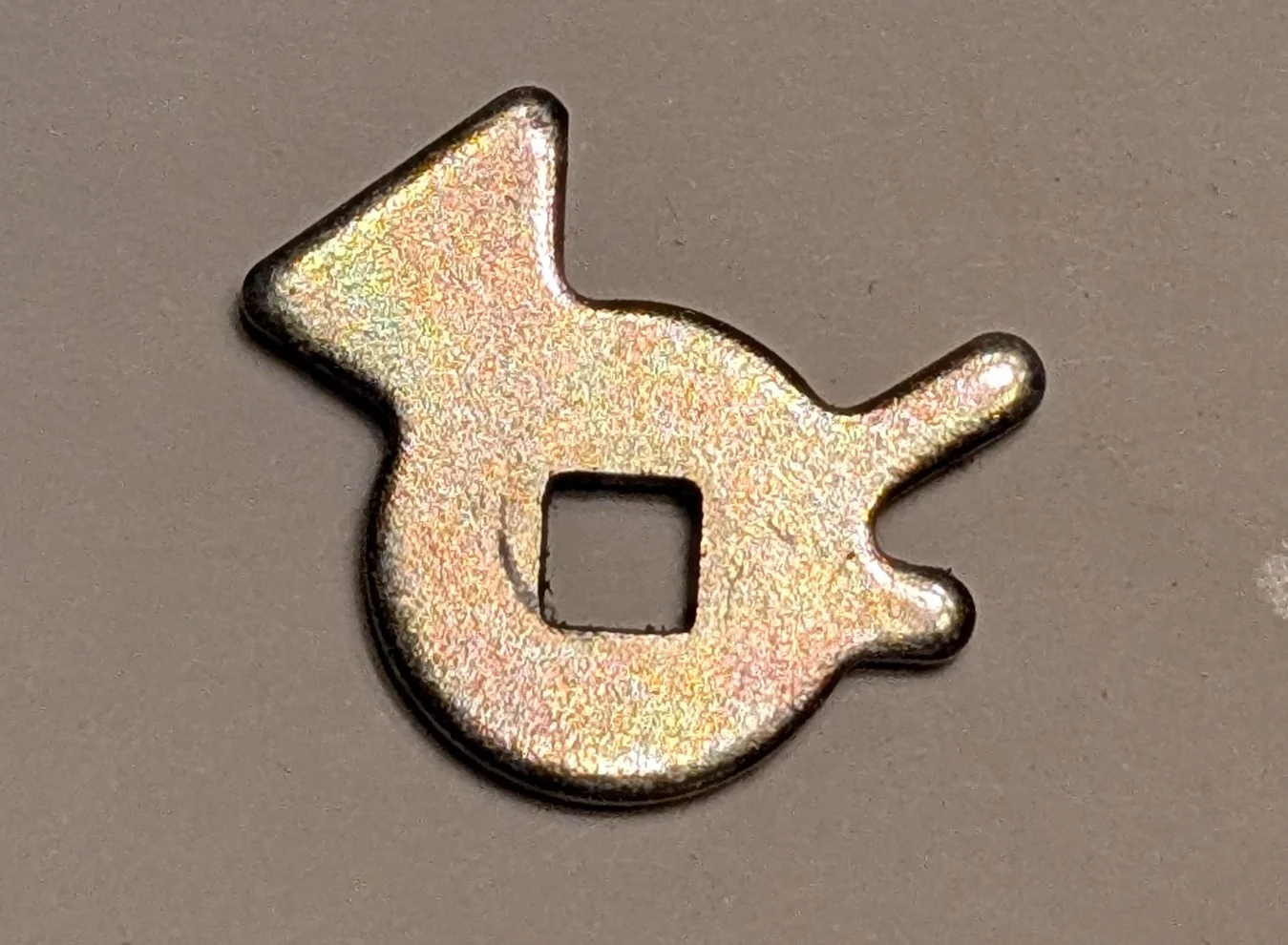

The wiper switch it pretty simple/clever too - I recall it's kind of a metal washer with a square center hole and two bunny ears. Twisting the knob passes the ground from the switch chassis through one of the bunny ears to a contact, and handles the switched ground signal. I'll be curious what you find.. . unless the rotary spring is kaput, it's pretty failsafe.

was it this bad ?
or worse ......:confused:
Looks more like a dog for a latch to me. Rorschach was a fruit cake, likely had mommy issues.
