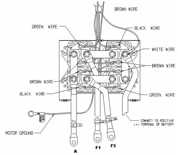

johan peeters 10 Year Joined May 1, 2012 Threads 26 Messages 135 Location belgium Website www.nooitnooit.com Sep 27, 2012 #1 this is for anyone who needs itpicture 12V PDF 24V Attachments Wiring M-8 24v 28396-1-1.pdf Wiring M-8 24v 28396-1-1.pdf 148.9 KB · Views: 450 Last edited: Sep 27, 2012
