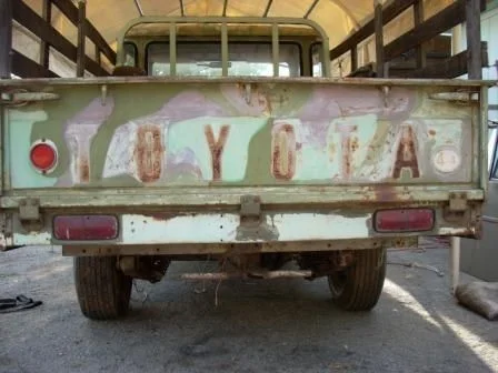

started cleaning up and doing the brakes on 67 fj-45 and i pulled the hubs off the front just to clean and check things out my queston is should there be a snap ring on the end if the axle shaft like my 40 ??? thanks other than that things are coming along
