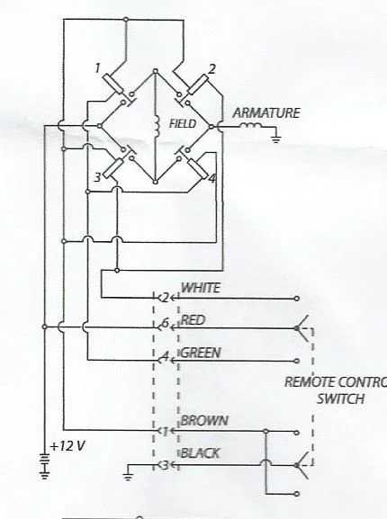

I just bought an 8274-50 here on Mud, but it appears that it may have a bad solenoid. The motor will spool out, but only clicks when I spool it in. I've cleaned the connections and still no luck. There is surprisingly little info on the Web about the newer 8274-50 wiring.
So, this issue would most likely be a bad solenoid, correct? If so, how do I know which one(s) it might be bad? There are four:
This is the 5-wire connection diagram. Let me know if you need the 3-wire.

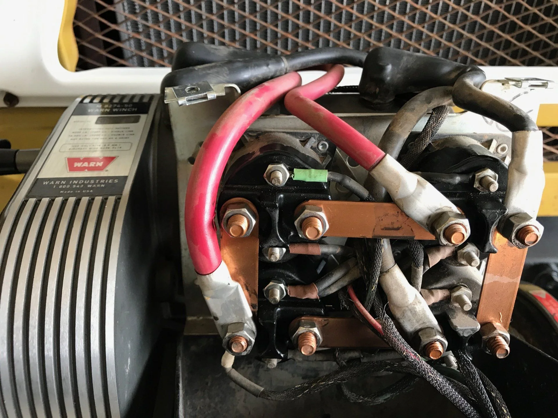

Thanks for the replies. Before I look into going with the Albright (which looks like a really good option), I want to establish what the issue is.
I removed and cleaned all four of the solenoids last night. When I reassembled everything, it briefly worked properly and went back to clicking. Thinking it was a bad connection or ground somewhere, I removed every connector again, cleaned it, and reassembled. Now, it will spool in intermittently, but clicks most of the time.
I'm trying really hard not to get pissed, since I just bought this winch from another mud member.
Question is, can a solenoid work intermittently?
Absolutely. I worked cranes for many years and 12V and 24V relays are notorious for intermittent issues.
Thanks, @spotcruiser. I think that's what I'm dealing with then. A bad solenoid is in there somewhere.
If you want to just spool in find the good spool out and replace with the bad one (test with the continuity test) and have intermittent spool out (spool out is mostly used in downhill braking) I mostly use manual spool out as it is faster, attach cable and spool in.
