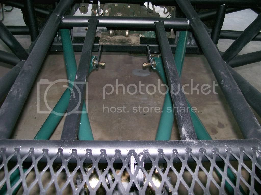

my heims are 5/8 bore 3/4 thread QA-1's...EXMR series....haven't replaced one in 4-5 years, tho my lower 1/2" wall links have a bend...
my lowers are splayed more than in those images now, to the outer ends of the axle tube....IIRC, 1/2" rear steer at full travel...

Ya, you look at those pics and it looks like you would get a buntch more rear steer than you mentioned.

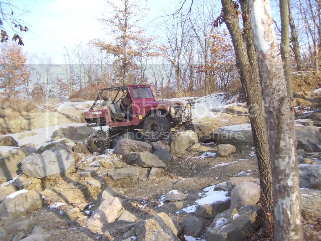

pic from early Dec in Attica....you run my numbers thru the 4-link calculator and the results confirm the minimal rear steer
The long, flat lowers really do a good job of minimizing rear steer. It is the abrupt angle changes that create most of the issues..
Short lowers like bob has make rear steer a much bigger deal..

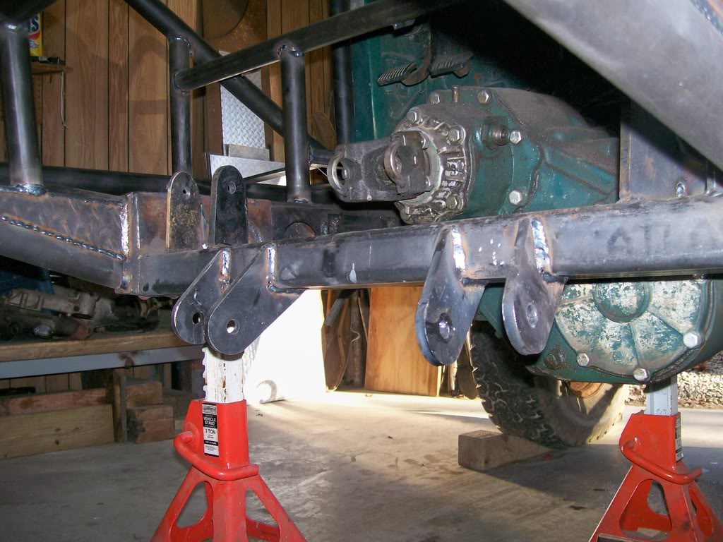

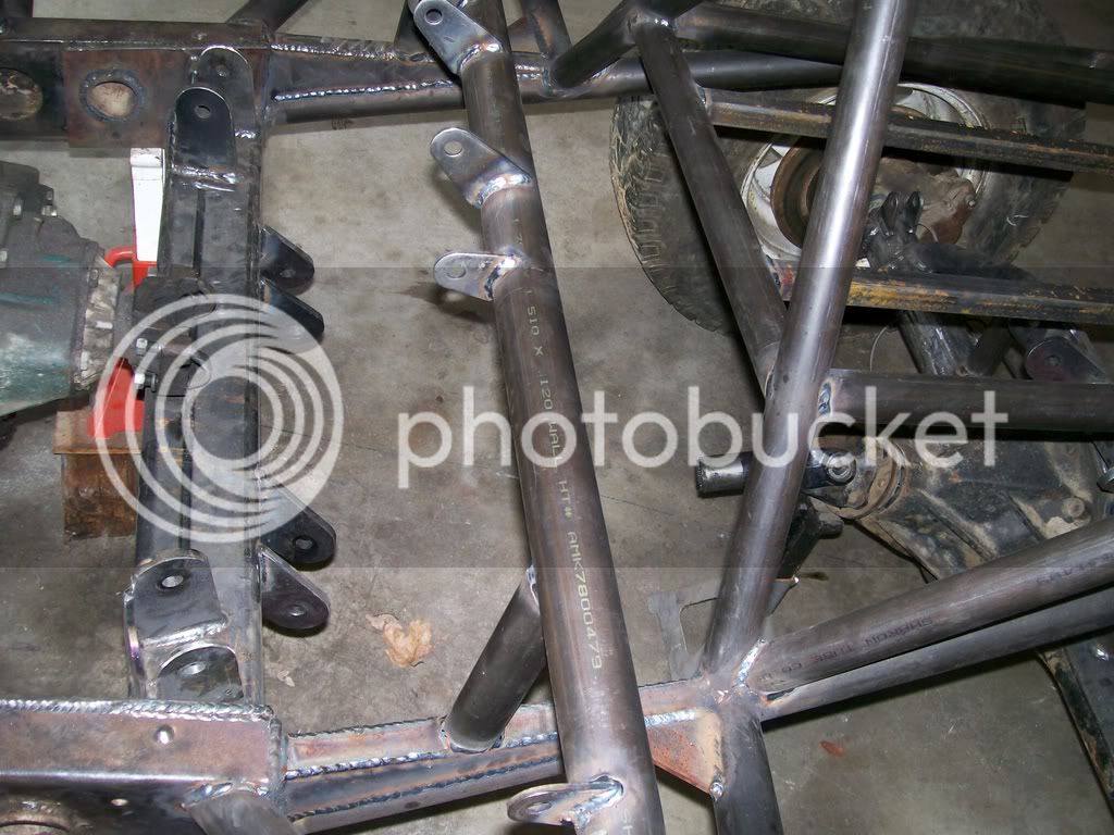

I'm assuming your rear axle is almost a couple of feet back the stock location?
Also looks like you just triangulated your links with no angling at the mounts.
It's probably not that far back. I can still see where the stock spring hangar riveted to the frame, I could measure it.. but most of my stretch is up front. the centerline of the front axle is basically under where the OEM radiator would be.. (I'm at 110" WB now)
All the frame-side mounts are angled, to minimize the angle on the joints.. The upper brackets are the 22° ones, and the lowers are a little less than that. The axle mounts, being just tabs, were angled as well.
