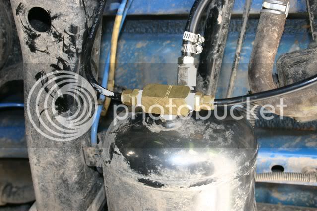

Ok, I fixed the drain issue. Just used a T fitting to connect the pressure switch and the gauge to the same port. Now the drain is on the lowest spot on the tank. Here is the new T fitting:

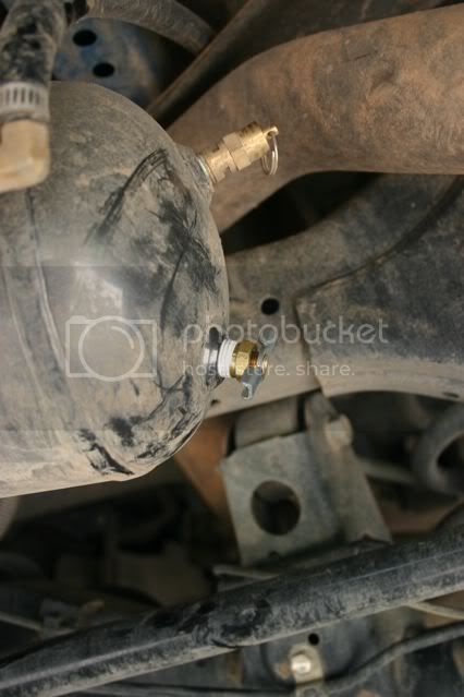

And the new drain location:
