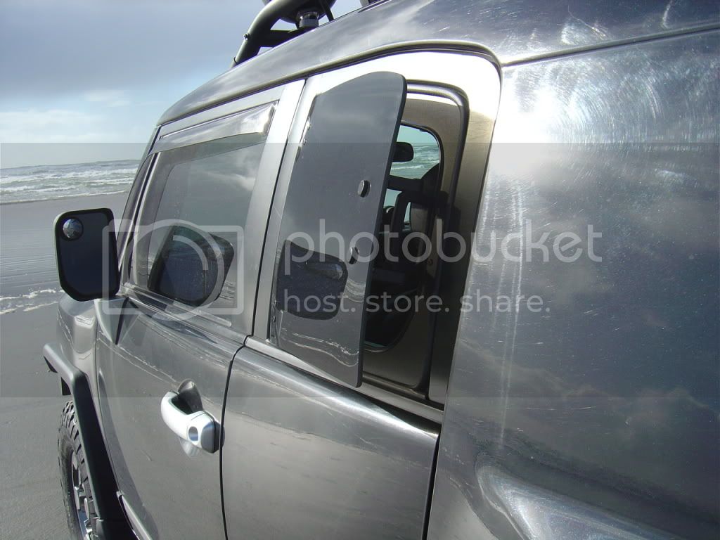

Looks interesting. This is something the FJ desperately needs. It is really going to depend on the seal and quality of the material. I'd be happy with a vented glass window that you could open when you want to drive with the windows down to prevent the bad interior turbulence and beating your ears take. Looking for to the review.

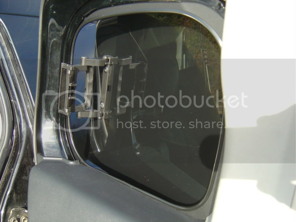

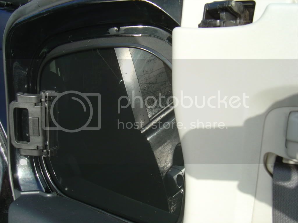

I would just pay someone to remove the fixed glass panels. It was not something I would do again. Expect to pay from 50 to 100 bucks for that. Here is a couple of pics from the inside as several people have asked me to post.
