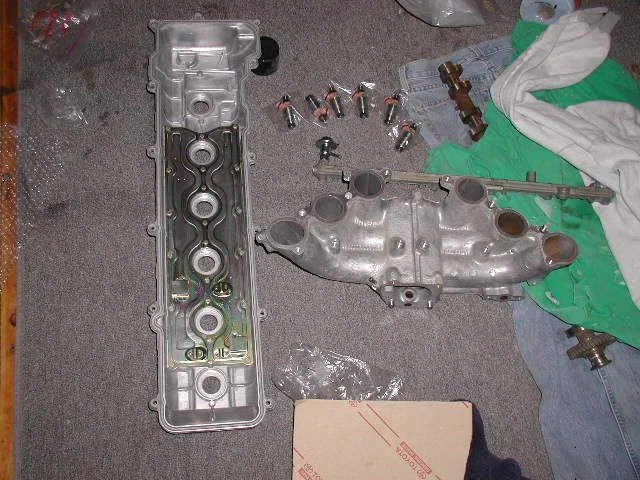

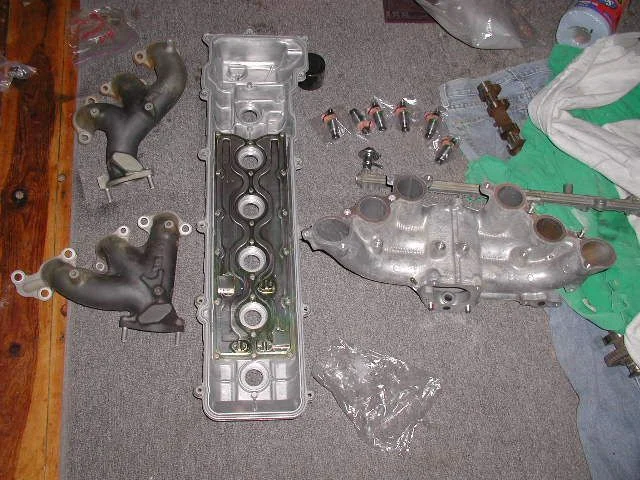

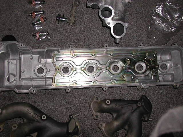

valve cover+throttle body PM w/pics

Wow LX, that's almost as clean as mine!;) How did you get it looking like that? I'm almost embarrased to show mine.
IMHO, that's not clean. I agree with LX who has the monopoly on clean engines... :) This is clean:
I am impressed. What do you use to get it this clean, or it is a new one?

Beno, I think you may have missed the sarcasm hidden by the winking smiley. Yours is uber clean as well.
I just couldn't find the "magic" chemical to clean the bugger. I was primarily concerned with copious amount of oil I was losing.
BTW: the truck had Mobile1 run through it for the past 30k miles prior the the thread.
TK
BTW: the truck had Mobile1 run through it for the past 30 miles prior the the thread.
TK
Sorry....slow on the uptake these days...
machine shop cleaned by the way.
