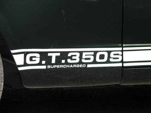

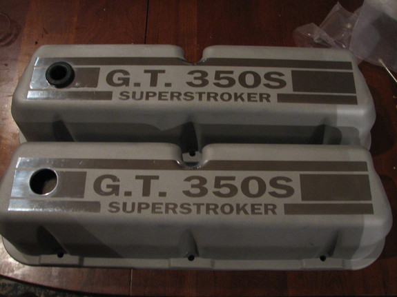

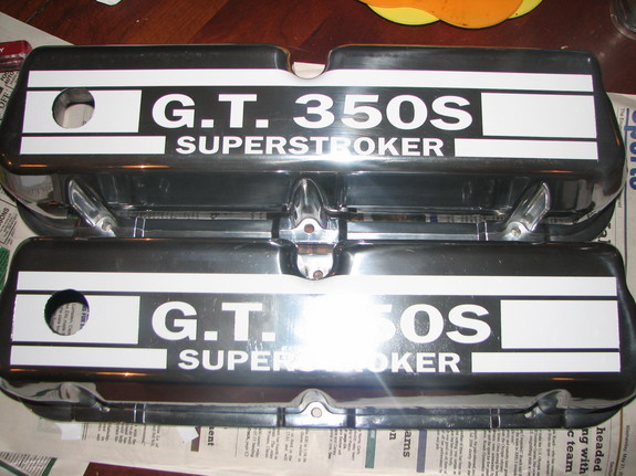

Get it sandblasted, prime the covers, decide which colors you want and head to a sign shop. Ask for pre-mask lettering, spray your bc, next is a dcd500 if I'm remembering correctly, apply your lettering and spray the other bc then spray cc on everything.
Both of the items below where done that way. The valve covers had the masking done then sandblasted where the fenders where done they way I described to you.
