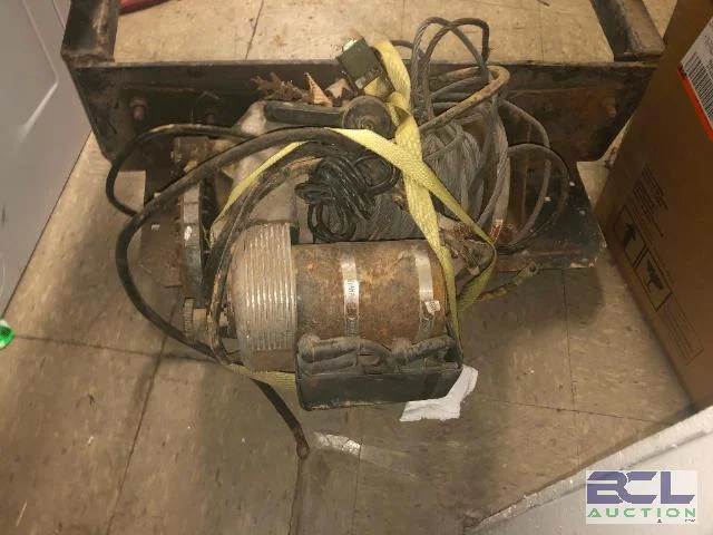

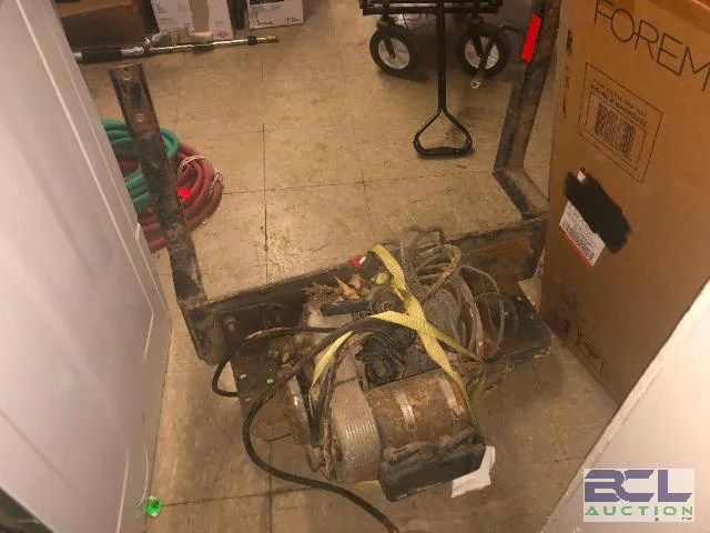

Just got this at an auction for $45.00. Had the wife go get it and she hated me cuz it weighs so much and she another gal to help her load it. GRRRR. Anyhow I got home from work and unloaded it with a friend of mine and it is in really good shape! Couldn't tell from the auction pics. More to follow as I haven't had a chance to even look at it yet!
It is a mighty 8274. Possibly the best electric winch ever. You absolutely stole it for $45; just the parts are worth way more than that. Warn still sells these new, for $1,800 (last time I looked).
That can easily be made to work. You need to know if the motor works but even if not, it's still a great deal since numerous Warn motors will work on it.
I'm guessing for $500-$700 or so, you can put a new motor, new brake and new solenoid pack. And you'll have an $1800 winch. Anyway, for $45 you did very well. I paid $350 for one and thought I did great! If the motor works, you can just rebuild the rest for small $.
Lots of rebuild videos on this winch. The fluted cover indicates it is indeed a Warn 8274 that they still support with parts. you could rebuild it and easily sell it for $600. I have one of these and it is indeed an amazing winch.
