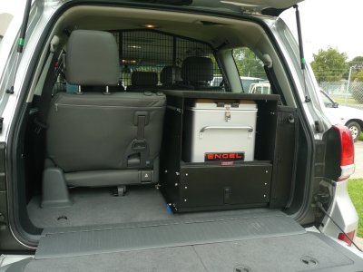

Taco, is that a homemade fridge slide/box? If not, what is it?
It's made by Tanami 4WD in Australia. The only issue I have with it, is that the slides need to allow a 100% extension. That way, you can access items behind the fridge, and not waste that space. I used to put two Scepter water cans behind my fridge and now a portable hot water heater there, so making sure the slide comes out enough to allow space to remove those items from around the fridge, and its enclosure is key.
Here's another option.
Thanks! Very helpful to see a picture of one in use. It really helps me envision it even though I won't have a fridge sitting on the shelf I may put other luggage on it. Most the time I won't even have the 3rd row seat deployed. I just want to make sure it is an option when needed. BTW, do you leave the wire cage in place behind the 2nd row while using that seat in the 3rd row? Is this for when one of the kids needs a "time out"?
