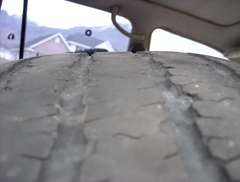

Whatever you do, don't let it get down this far... These were my old tires.
attachment.php
