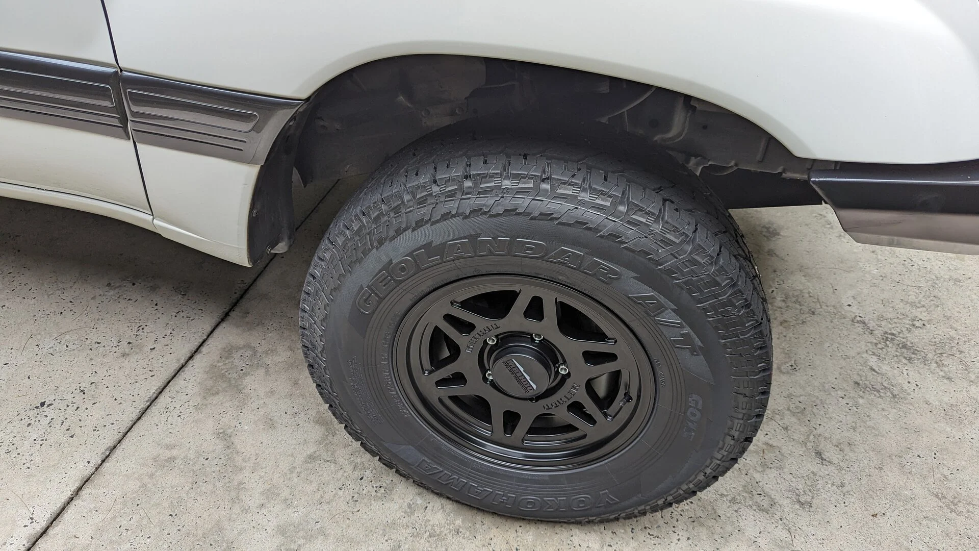

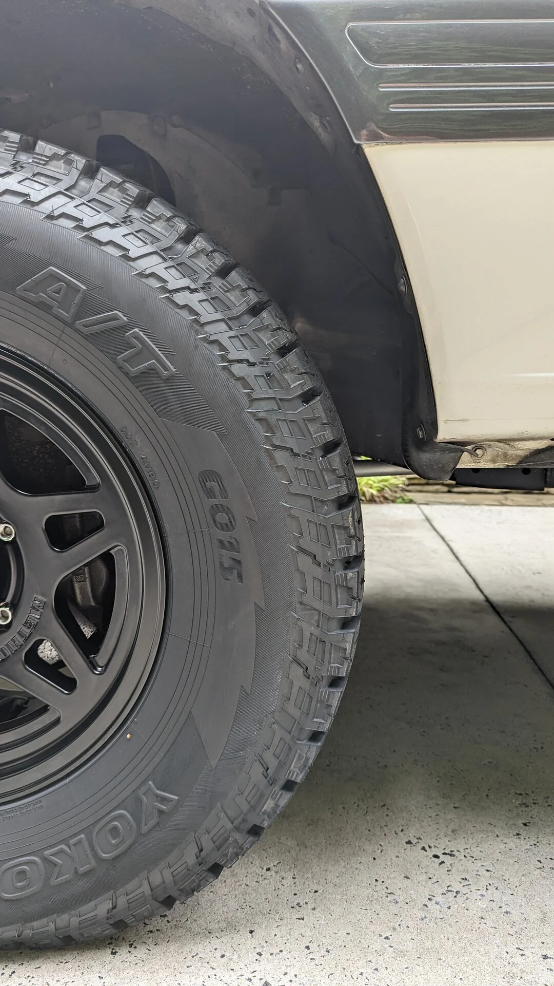

Friends...I received numerous PM regarding my tire fitment from my last post ... so here are a few more photos of my new 285/75/17... +35, 8.5" wheels... No rub, no trim fitment.... and NO, I have not run this combination at full wheel lock at speed....full wheel lock and full compression is not something we would normally do at anything more than a slow or even crawl speed....to test it, I intentionally hit some curbs, dips and holes at strong angles with zero rub....but not at 100% max turn....again, zero rub or contact....I think its a nice and practical compromise from putting on huge tire and wheels that end up causing problems....thats Ok for some that do more off-road...but for me, it is 90% on road. See my prior post for more details. Hope this helps someone that is looking for options....Be Well my Cruiser Friends.
