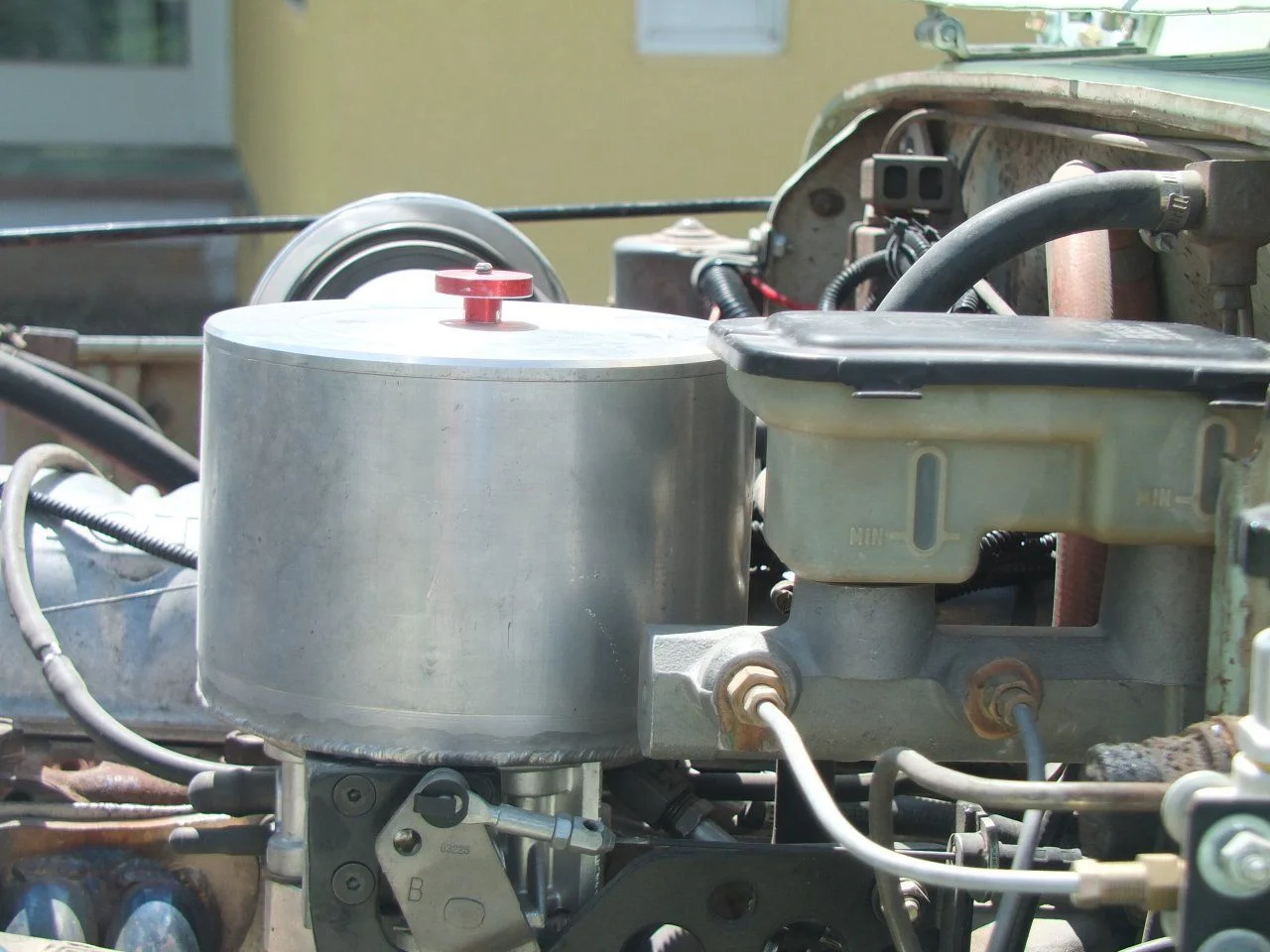

I curently have a manual brakes on my 69' fj40 .I did a 4 wheel disc conversion several years ago and replaced the master cylinder with a S-10 master cylinder . and i am running 35" tires .i don't have much room next to the throtle body [2F conversion and AFI fuel injection] ,air cleaner .A friend said their is a thred on useing a hydro asist brake off of a one ton dodge .I am familier with this unit in have a Dodge.Can someone please direct me in the right direction so i can get the this in formation.

Ok i look up this site , but it does not do anything for me . i have a 2F in it and the unit would run right in to the air cleaner , it has AFI injection kit if i had some sort of offset fot the brake pedle and get it past the clutch master cylinder it would work. does anyone have any suggestions?

Wha carb is that?
It's a throttle body with a pretty cool filter assembly that Dennis fabed up. He will have to tell us what type it is though.

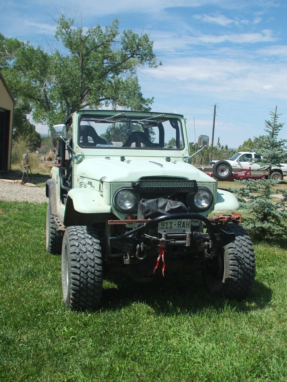

Hey Dennis, that light bar tucked in nicely, looks great!:smokin:
well it is a throttle body .as i said eariler in this thread it has a AFI kit on it . thanks for the noticing it Alic . AFI kit throttle body adaptor had to be milled out on one side to clear a head bolt and i also had to cut a hole in the valve cover to clear the throttle sensor plug. i think if i had to do it all over i would see if i could find a adaptor that Downey sold at one time or make one ,if i had a milling machine, then i would not have to be figuring out the power brake sinero. i thought about a offset mount for the hydro asist but that would put everything way out in the engine compartment.
