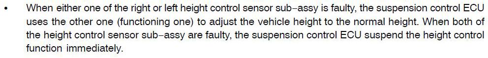

From previous findings usually the entire rear is raised or lowered if a sensor goes bad not just one side.
I replied to you on CL too. But no, that's not true.

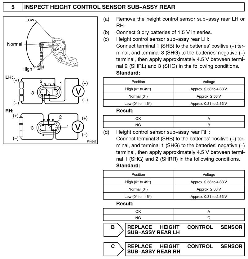

http://s140.photobucket.com/user/rrcompton/media/Lexus GX470/sensor.jpg.html
So if you had a faulty sensor the good one would still raise that side to the correct ride height and therefore would make the rear uneven if the other side is in the low position. But like I said check the sensor to make sure because it could be another problem all together.
What is the correct procedure to check the sensors for failure? It it something I overlooked in that other thread?
