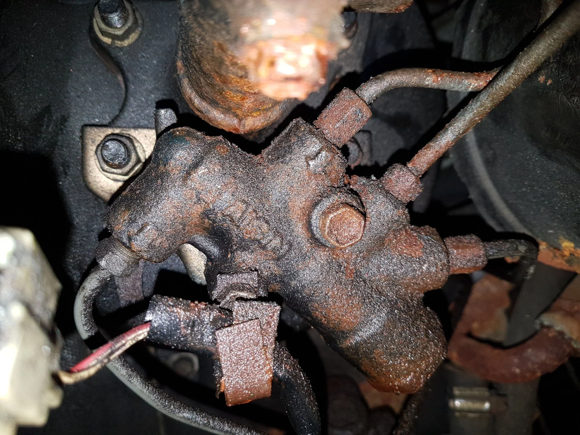

Hi everyone.
I've been trying to solve this weird brake problem that suddenly stops my truck without putting on the brakes. It releases and then I can drive, sometimes all day without it happening again. Recently, I found that I can just loosen the bleed screw on the front to release some fluid to continue driving.
In the past I've replaced everything except for the master, vacuum booster and the LSPV
I've been trying to find a new LSPV but have not been able to find this LSPV on any other 60. It's mounted under the brake booster in the engine compartment while everyone else seems to have one at the rear.......I don't have one there.
Anyone recognize it? Is it from another Toyota maybe?
Thanks

Yes, this is not Canadian, it's a Japanese market truck (actually, there is a sticker on the back of a New Zealand company that did the 24 volt conversion for accesories and trailer wiring, so, maybe it was in New Zealand.
I've searched all of the forums and looked at part catalogues and this part doesn't seem to be on any 60's anywhere. Since the truck was raised 2 inches, maybe someone didn't know what to do with the original LSPV and installed this one in the front? All of the proportioning valves that I've found online for the 60 look nothing like this!

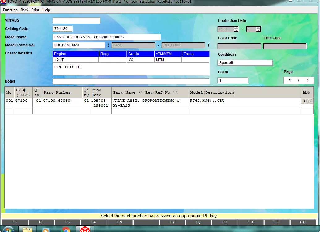

part nr 47190-60030
And it is in the original location on your truck according to the EPC program

It was answered on your other post. Its not a LSPV , it is just a Proportioning valve and is very common until 87 and was sold in most markets.
To be a LSPV, it much be attached to the rear axle so it can adjust the flow to suit the weight being carried.
Landcruisers of that era had either one depending on model or market.

My guess its something else causing the problem,most likely in the M/Cyl or booster.
The PV is just a type of flow valve. It diverts a percentage of the pressure in your brake line to the front and rear brakes. It doesnt make pressure itself.
Show me your vin plate ,then i can make sure which part nr you need
Should be HJ61 -########
ATM or MAN.?
89' models did have this valve,that is one thing you can be certain of.
This is what Toyota EPC comes up with.
VX -High roof-CBU (complete build unit)-MTM-TD
MEMZX is a code on the vinplate,which you can doublecheck.
Yes that's it. MEMZX

I do have exactly the same valve underneath the master cylinder on my 86 JDM 60. Even though I do not have a LSPV either I believe so far that that one is there for a different reason.
I thought that there is a pressure sensing, floating piston inside, it does nothing when everything is fine but if you are loosing brake pressure at the front or rear the piston moves due to the inequality of the pressures in the lines and shuts that circuit. I might be wrong but it is very likely what it does.
This valve is one of the few things on my 60 which I haven't had apart...
If for any reason - maybe foreign material in your master cylinder - a brake circuit (or clutch, same principe) can not release fluid back to the reservoir in a non braking situation, it will cause trouble.
Heat from the brakes is transferred into the brake fluid and this will expand. If it can't expand into the reservoir like normal - it will effectivly stay and maybe make the brake pads rub a bit - creating more heat transferred into the brakes - creating more pressure....et voila´ your brakes are jammed.
The problem could be in your master cylinder or inside your flexible hoses (most likely then only one side at the front axle but could be both sides at the back) but also your above mentioned valve could play up. If the valve is the one I thought it would be you could have moved the piston accidentely while bleeding your brakes. if you apply pressure to the system while the front or rear circuit is open the pressure sensing valve will move and close the open circuit. maybe one of your circuits is partly closed.....
Well at first we really need to know the function of that valve. I worked a lot on Landrovers years ago and they had exactly the same system. We were bleeding the front and rear circuits simultaneously to avoid any disturbance of that valve. Having said that - I have absolutely without any trouble bled my brakes one wheel after the next - On Landrovers and Landcruisers.. If you don't hammer the brake pedal to the firewall you´ll be fine. Somebody here who had that vave apart, or nows for sure what it is for ?
