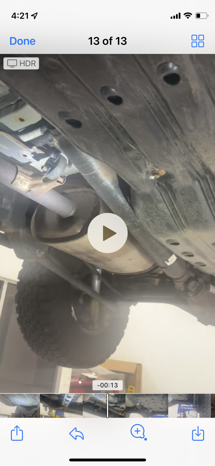

Thoughts on this? Worth to buy or look elsewhere.? Thank u

Yep for the FJ CRUISER. Still have my 40 and 80. I’m nuts. Need to have my kids show me how to convert this darn video. Looking at a 13 has some visible rust. Don’t think it is far too gone. Rust is trouble.

Looks ok to me (from Ohio).... Youll be needing some help getting bolts out I bet....and when you need new front lower control arms you will most certainly be cutting the old ones off. May check the rear panhard, link, and spring mounts just to make sure those are not worse than they look.
To really do it a favor a bunch of wire brushing and paint may be in order....then start Fluid Filming it to stop further rusting.
If the price is favorable, I wouldnt count it out due to what I can kind of see in those shots.
If the price is favorable, I wouldnt count it out due to what I can kind of see in those shots.L
