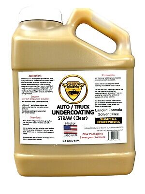

Why not use the 'spray on bedliner" products or the "rubberized undercoating"?
Does that not prevent water intrusion onto the body metal?
Those products do work but the fear is rocks or something will cause chunks to fall off. Then the water could get in behind the undercoating and start the rot unseen.
Oil, WoolWax, FluidFilm displace water. Spray on hardening coatings trap the water in and help it do it's job turning your rig to dust. Water will eventually get underneath any hard coating.
