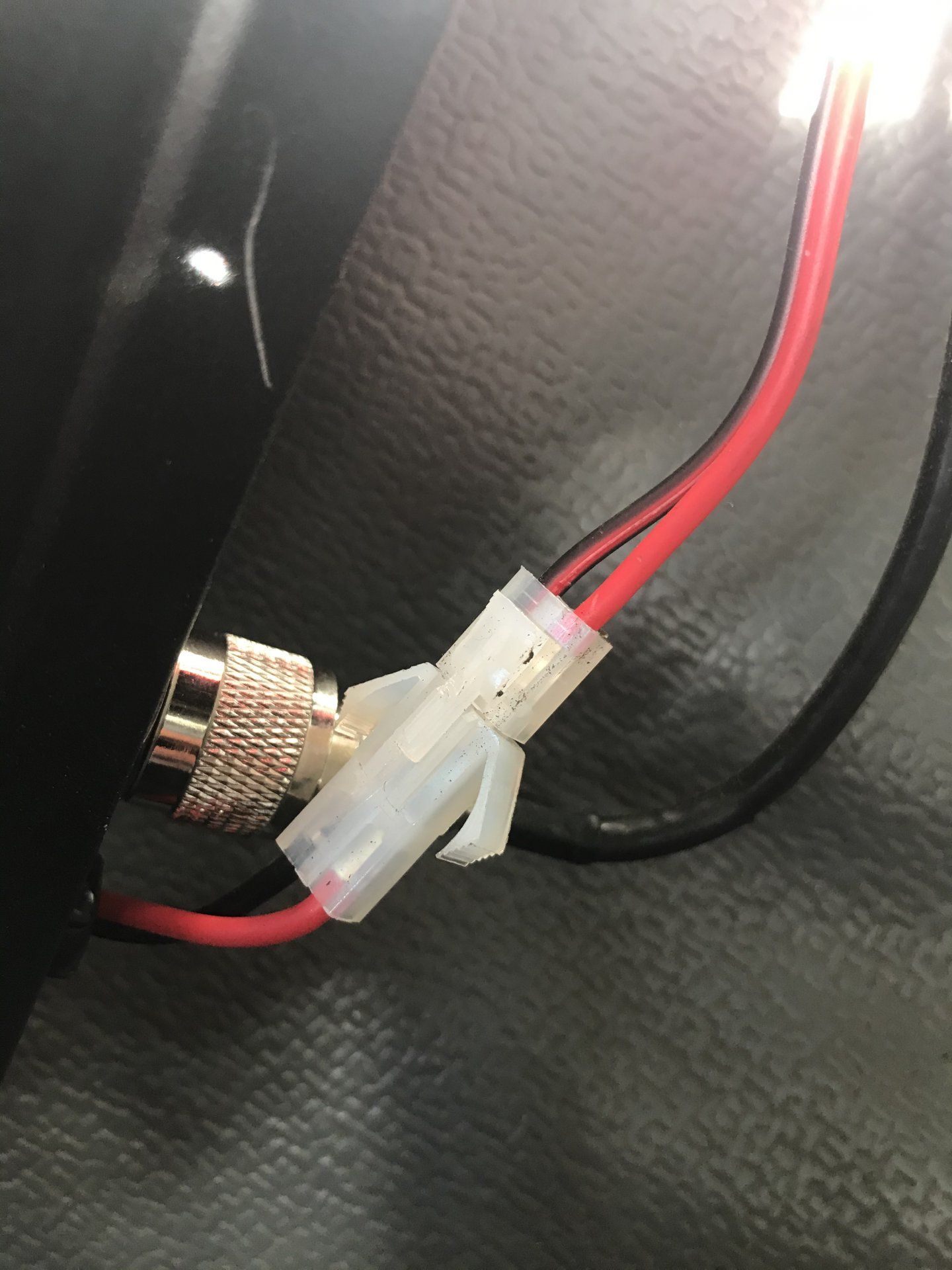

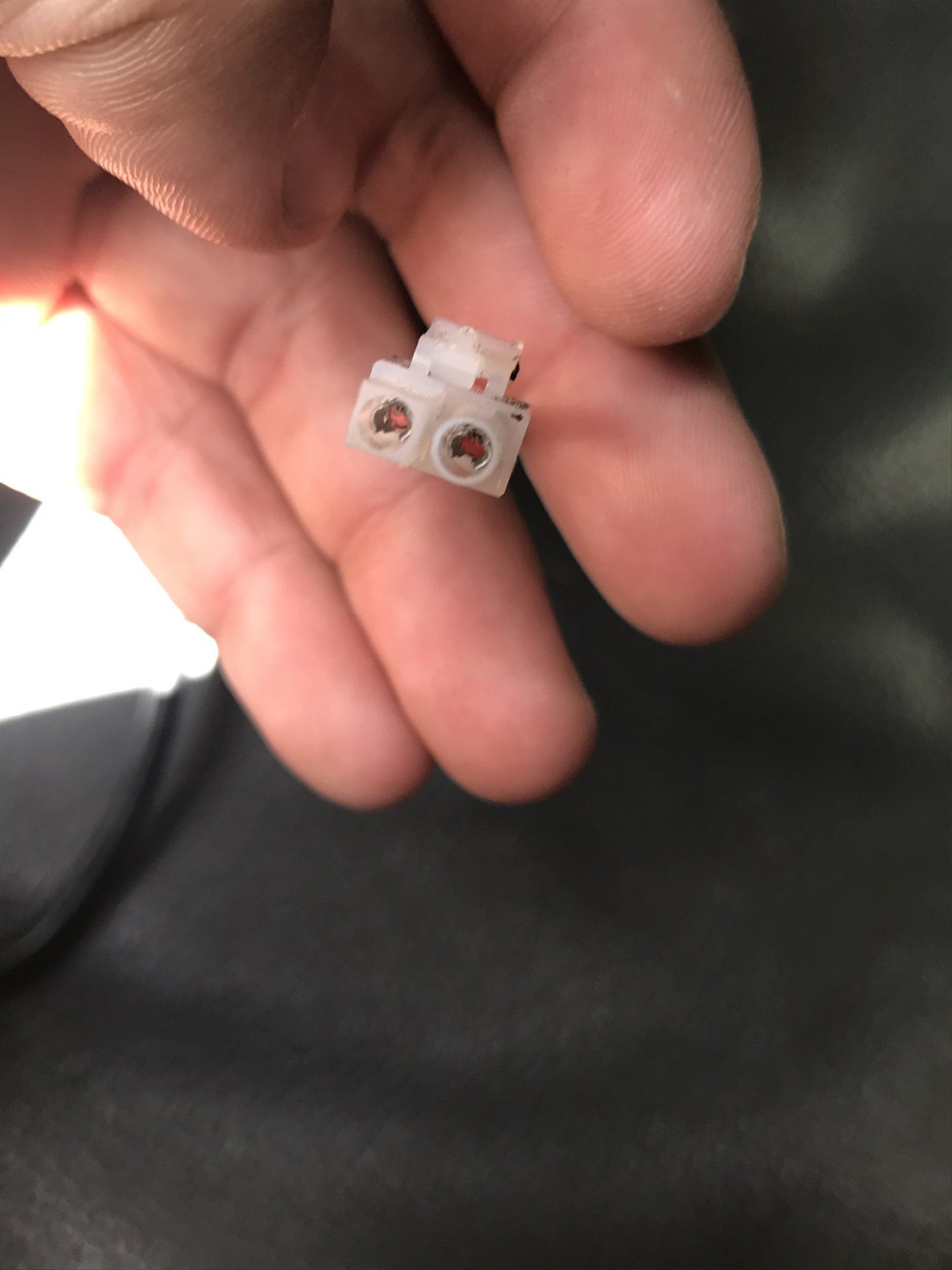

Got this oricom uhf brand new when I installed it it kept flickering on and off due to a loose connection but it’s got little probs and stuff I’m not sure how I would fix it any ideas?
I can't remember the connection type maybe a bullet style connector. In that case you can probably repair yourself just get some tweezers and closed the split connection a little tighter or use a very small jeweler's screwdriver and make the diameter smaller
