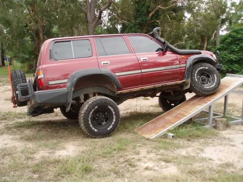

G'day guys, I don't often venture into 70 series tech I mostly hang out in 80 series tech and diesel and 24V tech. A mate just bought a set of 16 x 8 80 series steel GXL rims for his 92 HZJ75. He found they don't clear the front calipers. He asked me to do a search and find out if it is possible to grind the caliper to get it to fit. My search lead me here, so I hope you guys can help me out here.
So is it possible to grind the caliper or can you fit some narrow (5mm or so) wheel spacers?
:cheers::beer::beer::beer::beer:
Thanks Mick.
The 80 and the HZJ75 have different calipers fitted standard.The wheels off my Hj75 fit on the 80 but hang right outside the guards so I expect the 80 wheels have a different off set.As I said my 75 has been fitted with hzj calipers and had no problems with the wheels.
HZJ caliper fitted to HJ75
Mates is a HZJ75 92.
On 80s they had a brake upgrade around 92/93 which required them to change the wheels from 15 x 7 to 16 x 8. To fit 15" rims to later 80s it is necessary to slightly grind the caliper to allow the 15"s to clear but my mate is trying to fit the later 16 x 8 rims which are supposed to clear the bigger brakes without any mods. They seem to hit on the outside of the caliper near the wheel mounting flange which makes me think a thin wheel spacer might do the trick.
I wonder if this problem is a combination of the bigger calipers and maybe different sized hubs? to the 80. This would put the wheel mounting flange in a slightly different spot to the 80.
BTW he is trying to fit a set of rims the same as I have on my 80.
I was aware of the upgrade to the 80 so I thought if the 15s fit the 16 should have more clearence if the offset were the same being the 80 has a bigger caliper (92+).The only difference I remember from the hj and hzj hub was where the pad sits on the hub as I had to modify the hzj pads to fit against the 75 hub.Although the HZJ caliper sits app 1to2 mm further inboard this was nulified by a spacing washer.
Thanks for the replies I guess he will have to do some measuring to see exactly how far he has to grind/ add spacers.
I just feel bad :o as I was the one that recommended that he gets the 80 rims for his 75. Oh well if they don't fit maybe I can get a cheap set of spare rims;).
