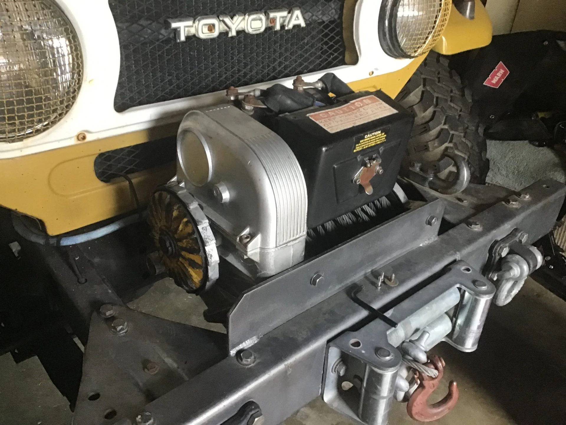

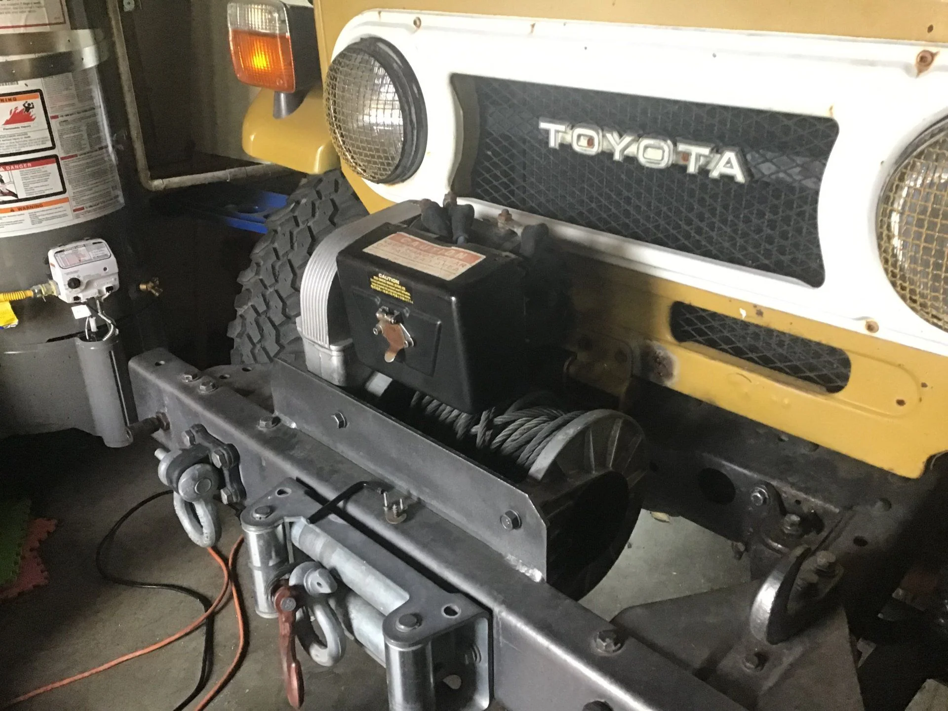

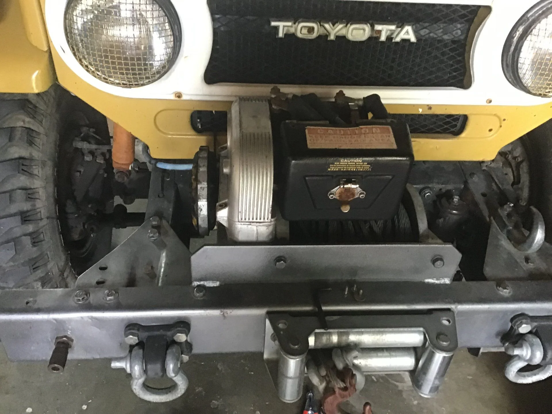

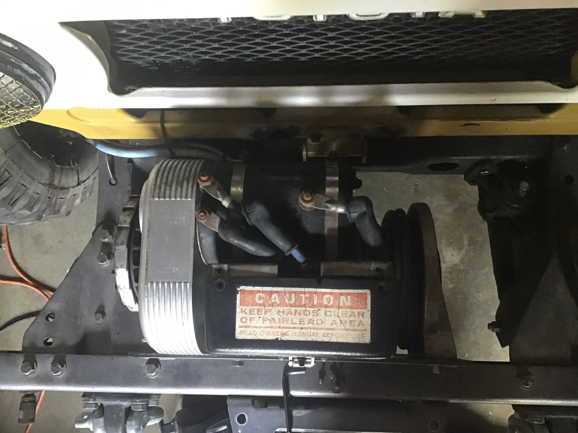

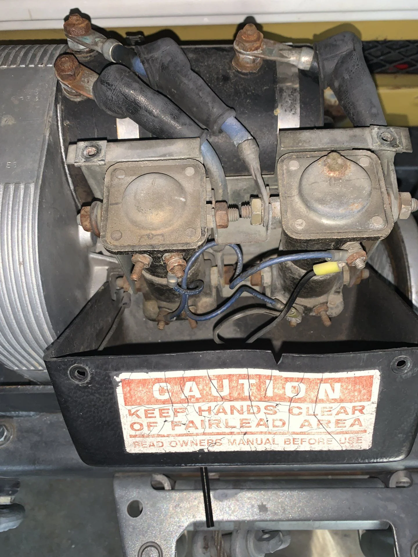

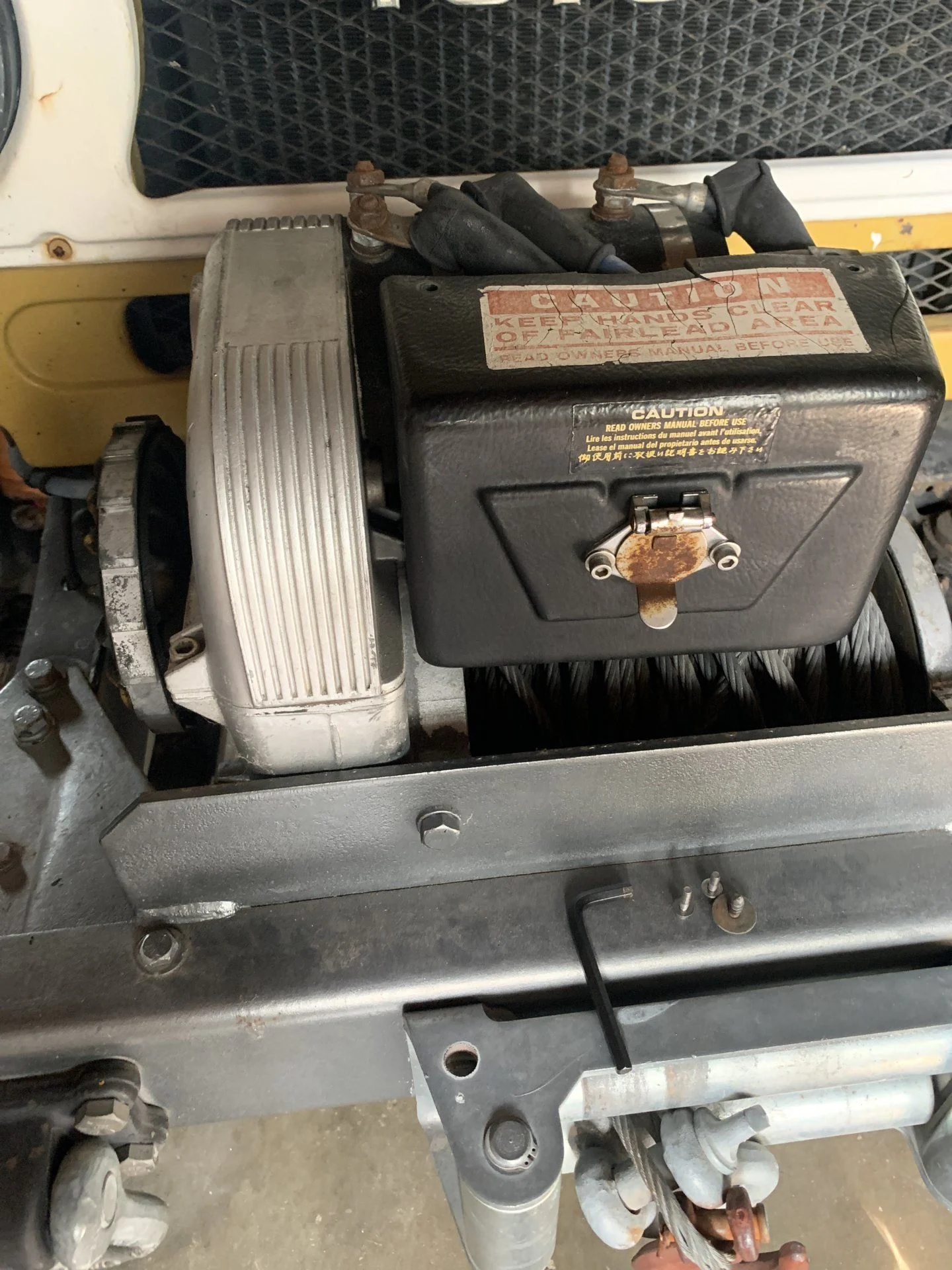

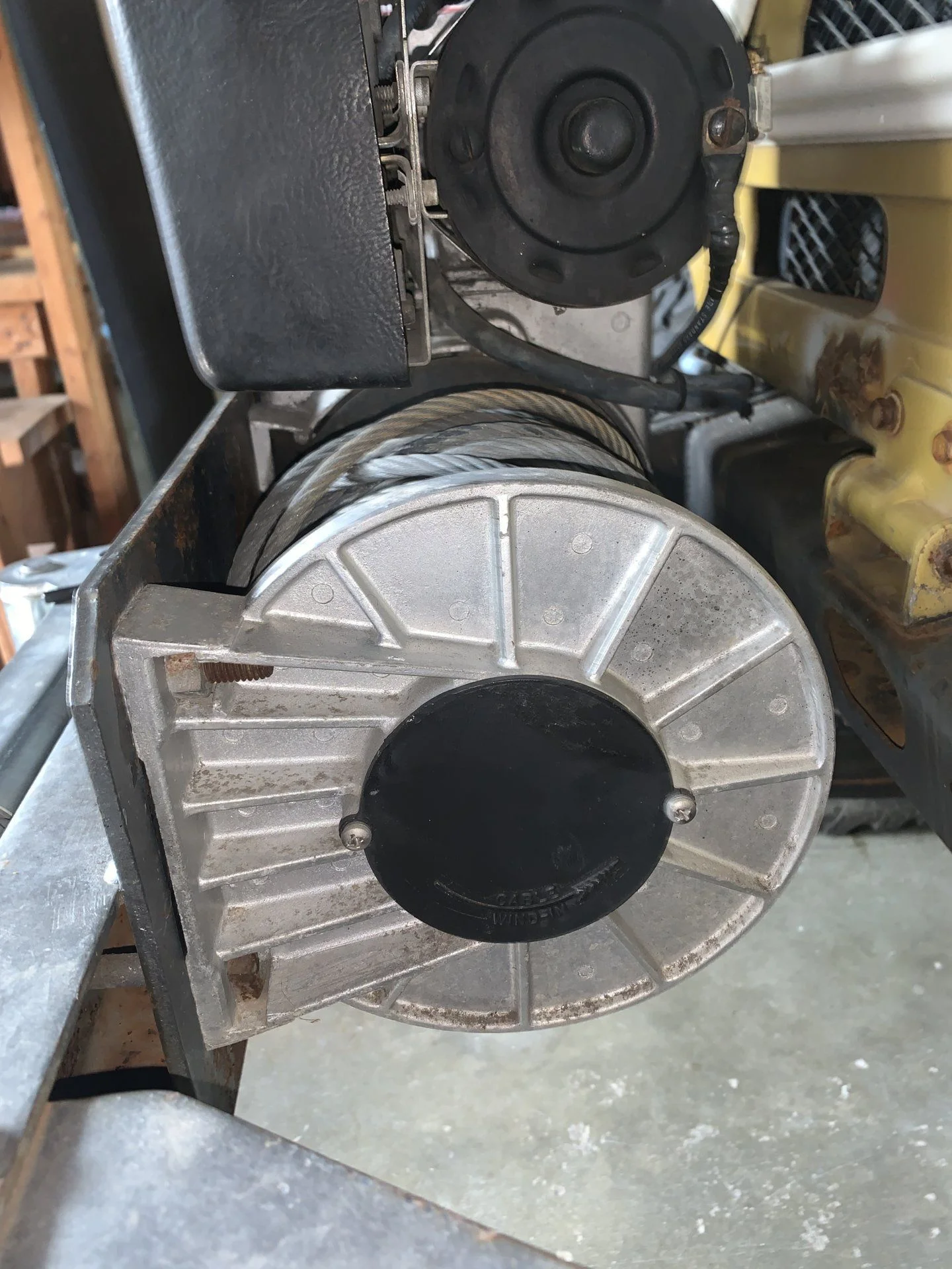

Just got my 76 FJ40 about 7months a go .. been working on various things to get it tip top. Now I’m running into trying to get the winch working. I know there are some YouTube videos etc. that have people refurbishing theirs or rebuilding their‘s. I just wanna identify which one I have so that they can then move forward to start rebuilding I’m not sure if it just doesn’t work anymore or if there’s a new part I need I don’t know if I’m starting to open it up but I don’t wanna go any further until I know exactly what I should be doing. Thanks for any help
8074 I think. Just like the 8274 except it doesn’t have a freespool knob.
Built sometime in mid to late 70s I guess by the style of the plug cover (metal).
Check this thread out:
You can still get parts for it at any authorized Warn distributor.

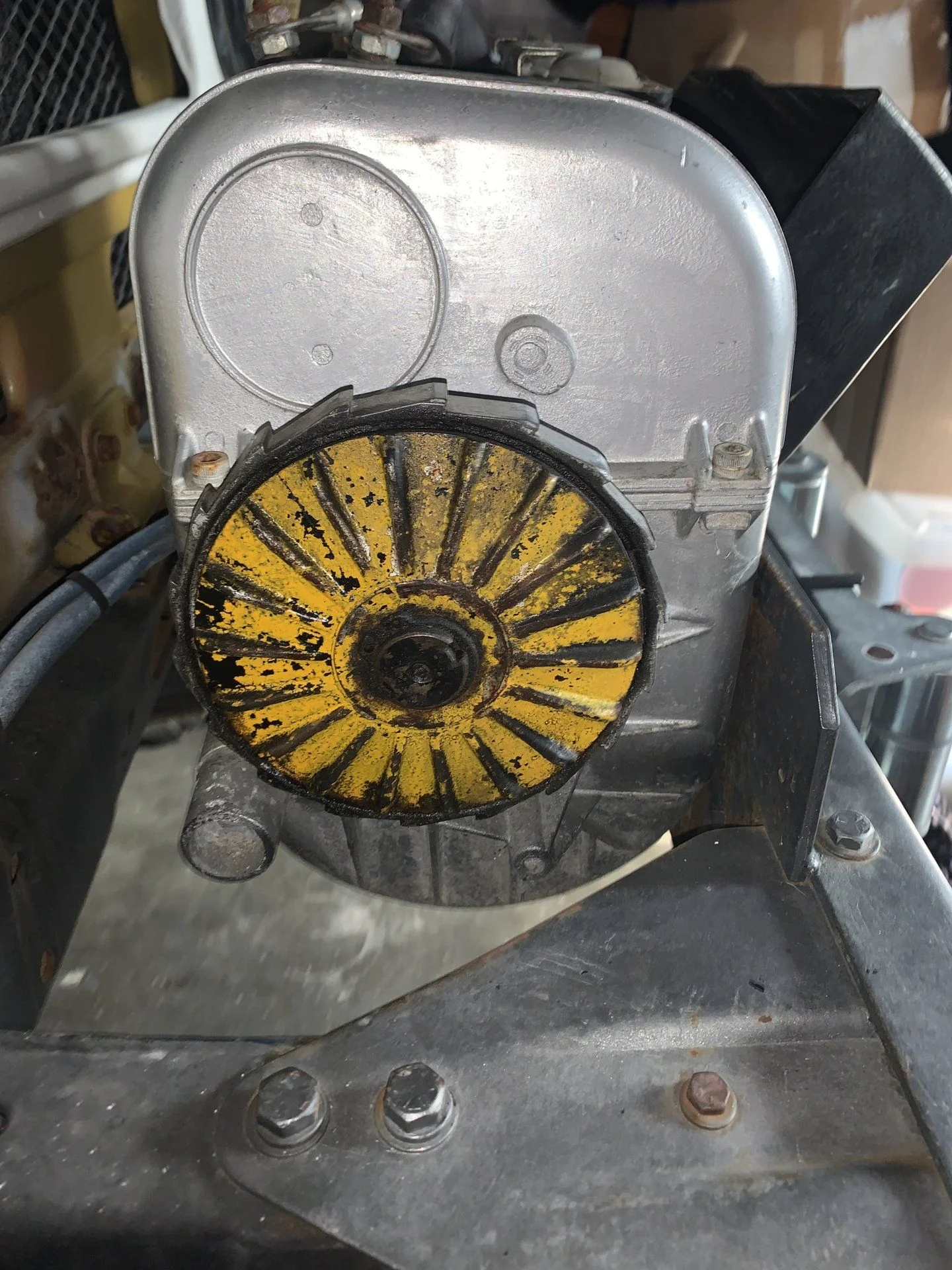

Still trying to figure out this model - definitely has all the 8274 aspects but no lever where there is one on the 8274
As subzali said, this looks to be an WARN 8074, so there's no freespool, only power in and out.
The "2" in 8274 stands for "2-way" as in power in/out and freespool. (8 = capacity 2 = power in/out & freespool, 74 = year it was introduced).
- Andy

The problem with the 8074 no freespool is that you can't pull the knob and freespool cable out, you have to power it out which is a lot slower and battery takes a hit as well...still a very good winch and will get the job done.

It seems I’ve seen or heard of folks buying the freespool pieces and drilling the hole in the case to install them.
