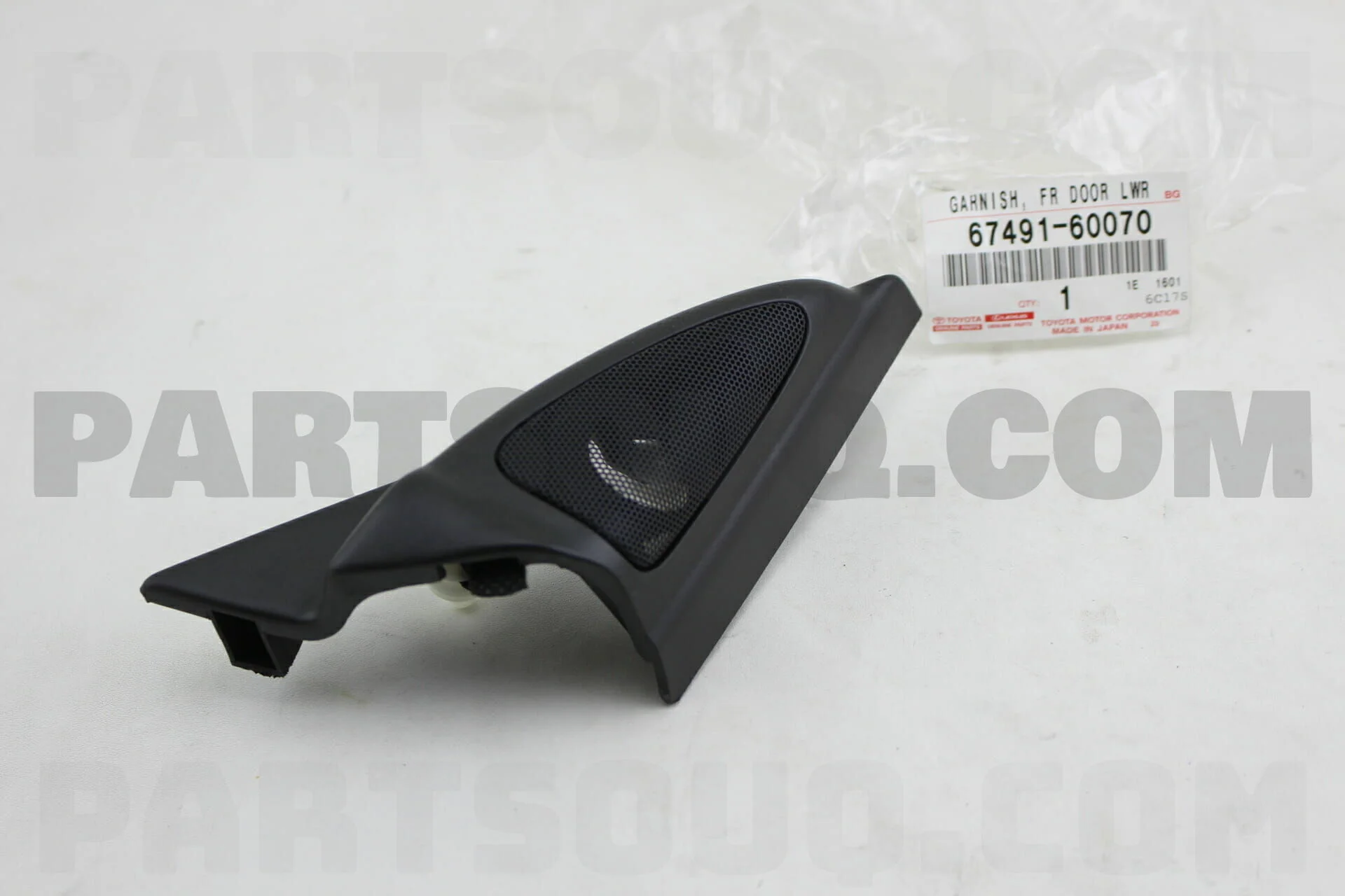

Hi, just wondering ARE these worth investing in, or should I just place tweeters in the front Left and Right bottom windscreen areas.
I guess I'm also asking what is better placement as well / are they good in these / do most tweeters fit in side these:
I don't think most aftermarket tweeters fit in these enclosures. I'm going to wind up taking my enclosures out, 3D scanning, then remodel and print out some that will fit my oversized tweeters. Just to keep them in the stock location but looking more or less "factory".
Yeah they look tiny , cheers

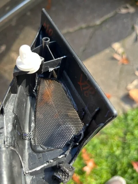

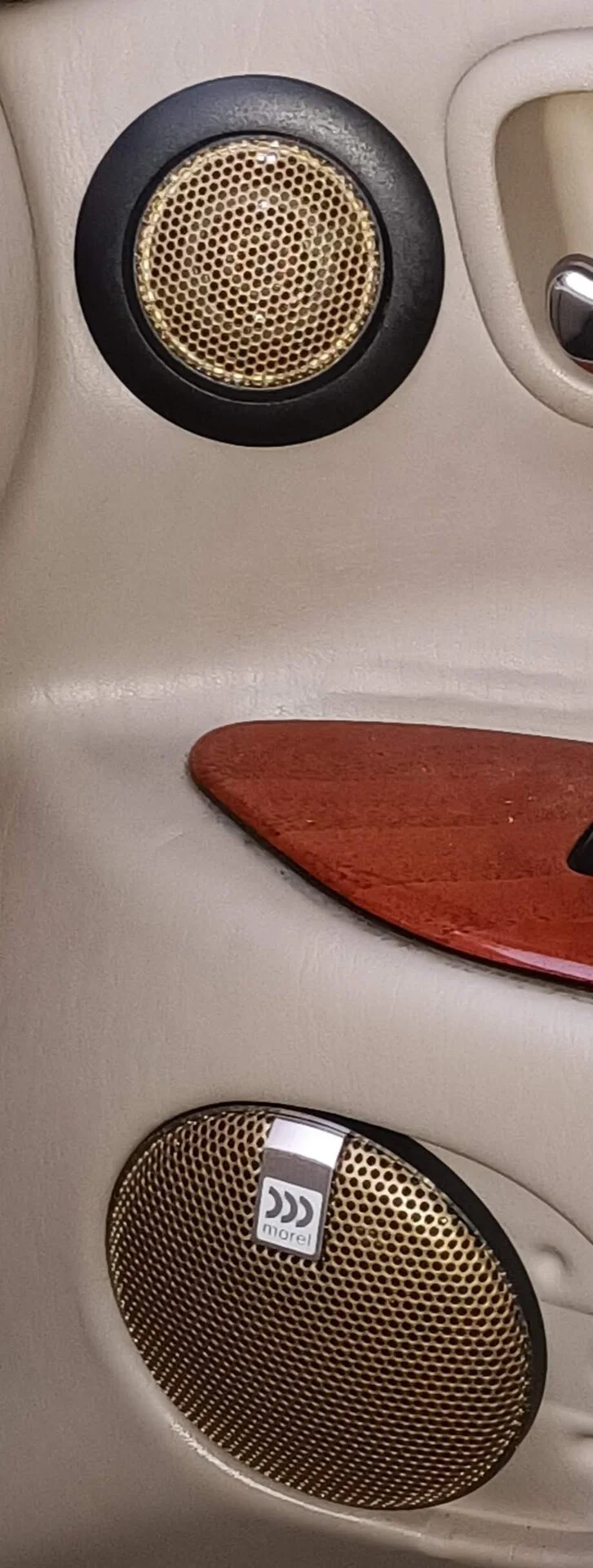

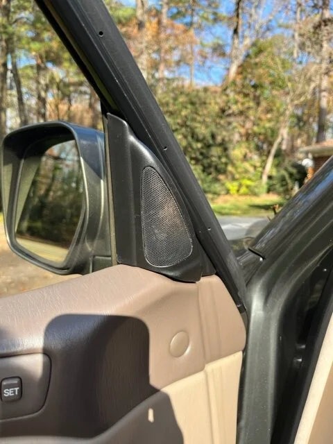

I put my Morel Tempo Ultra tweeters in the factory area, but had to liberally cut away most of the plastic to fit/angle. The mesh metal grill itself is removable (tabs), and as long as you leave enough area for the tabs to engage the grill, you are good. The mesh grill hides all the surgery behind it.
I put my Morel Tempo Ultra tweeters in the factory area, but had to liberally cut away most of the plastic to fit/angle. the mesh metal grill itself is removable (tabs), and as long as you leave enough area for the tabs to engage the gril, you are good. The mesh grill hides all the surgery behind it.
