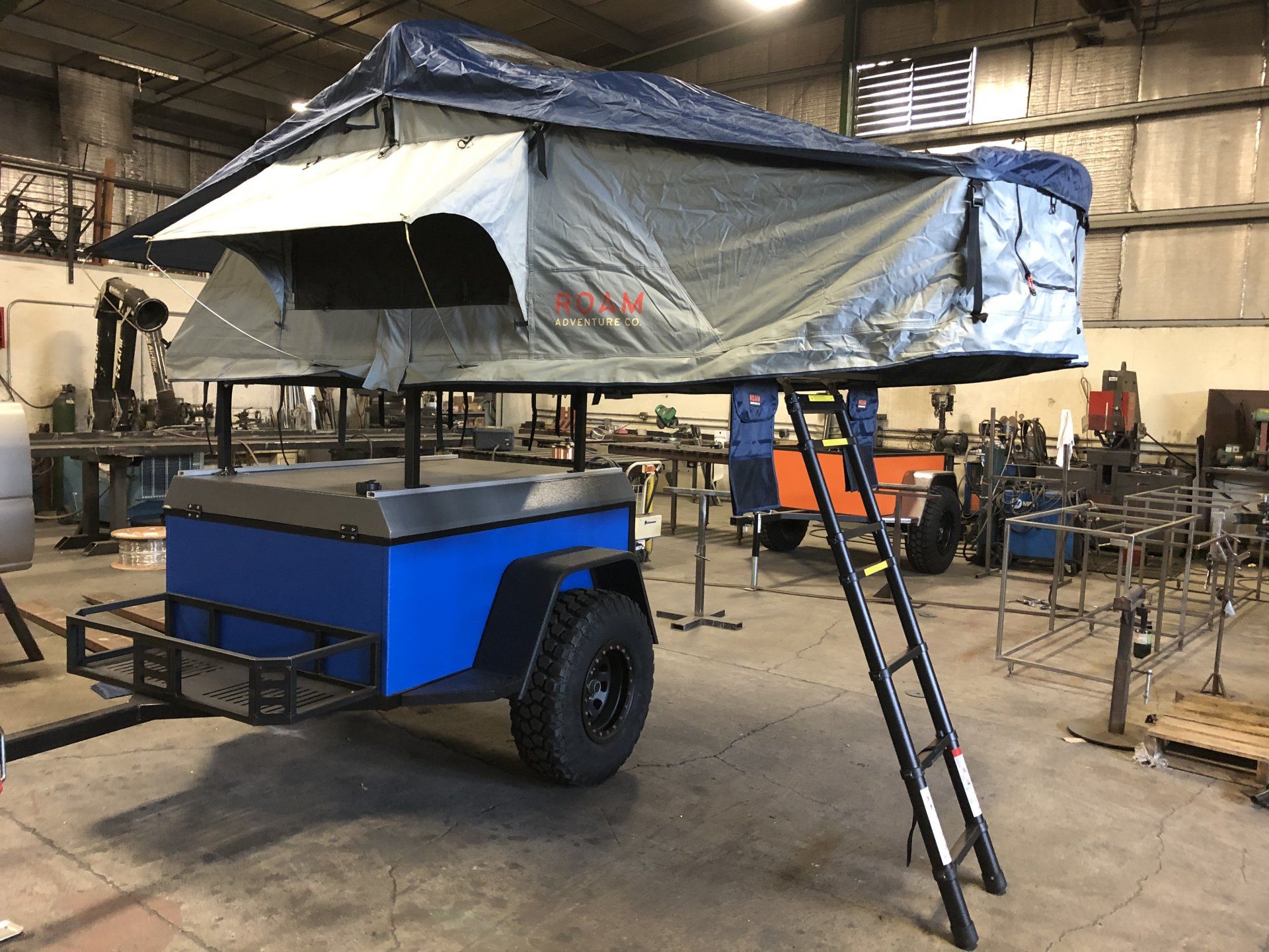

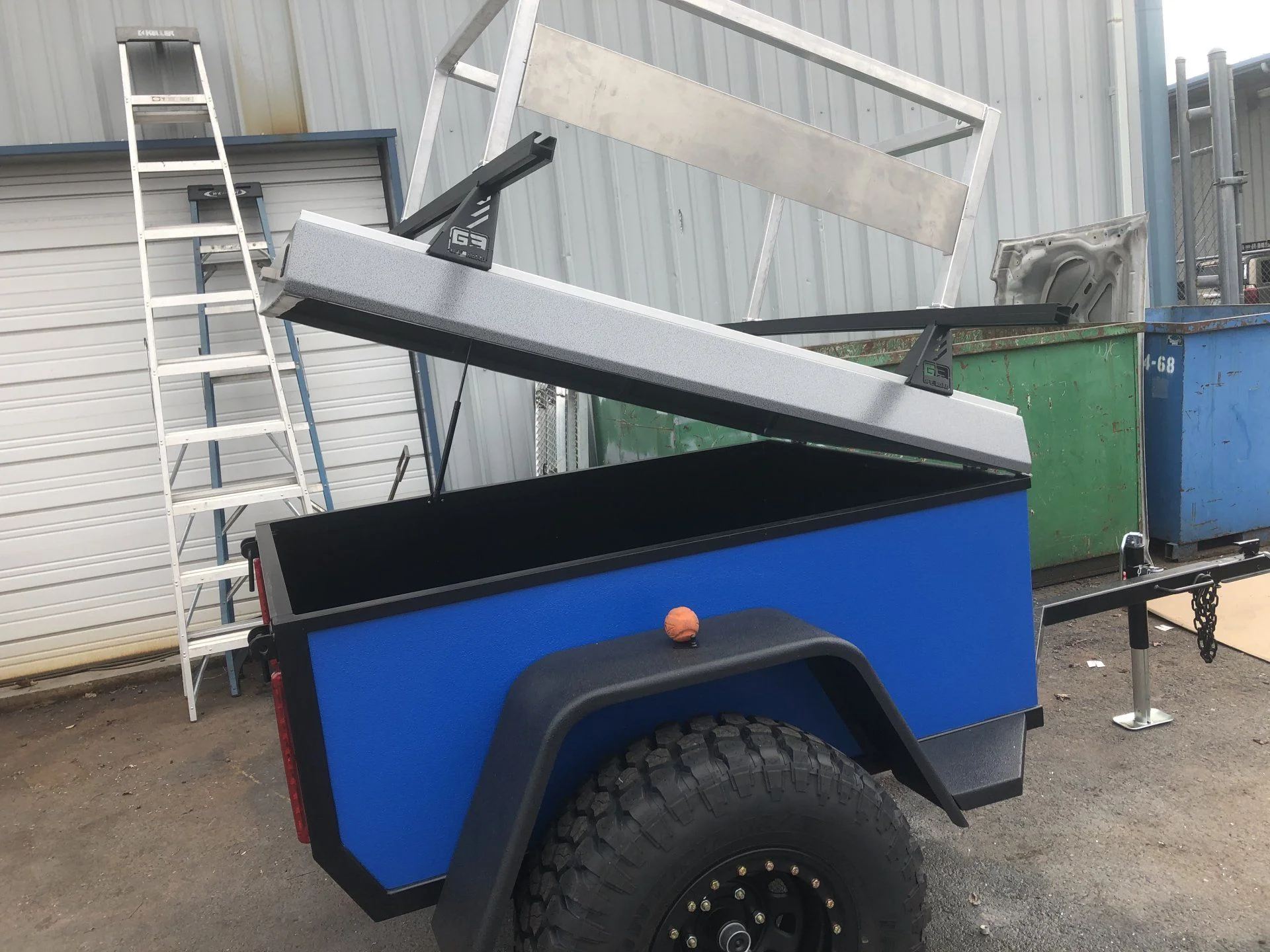

Make a Aluminum lid. then get a upholstery shop to make canvas walls so when you lift the lid it act like a hard top rtt tent
Something like this.
I can see something like this working 🤔.

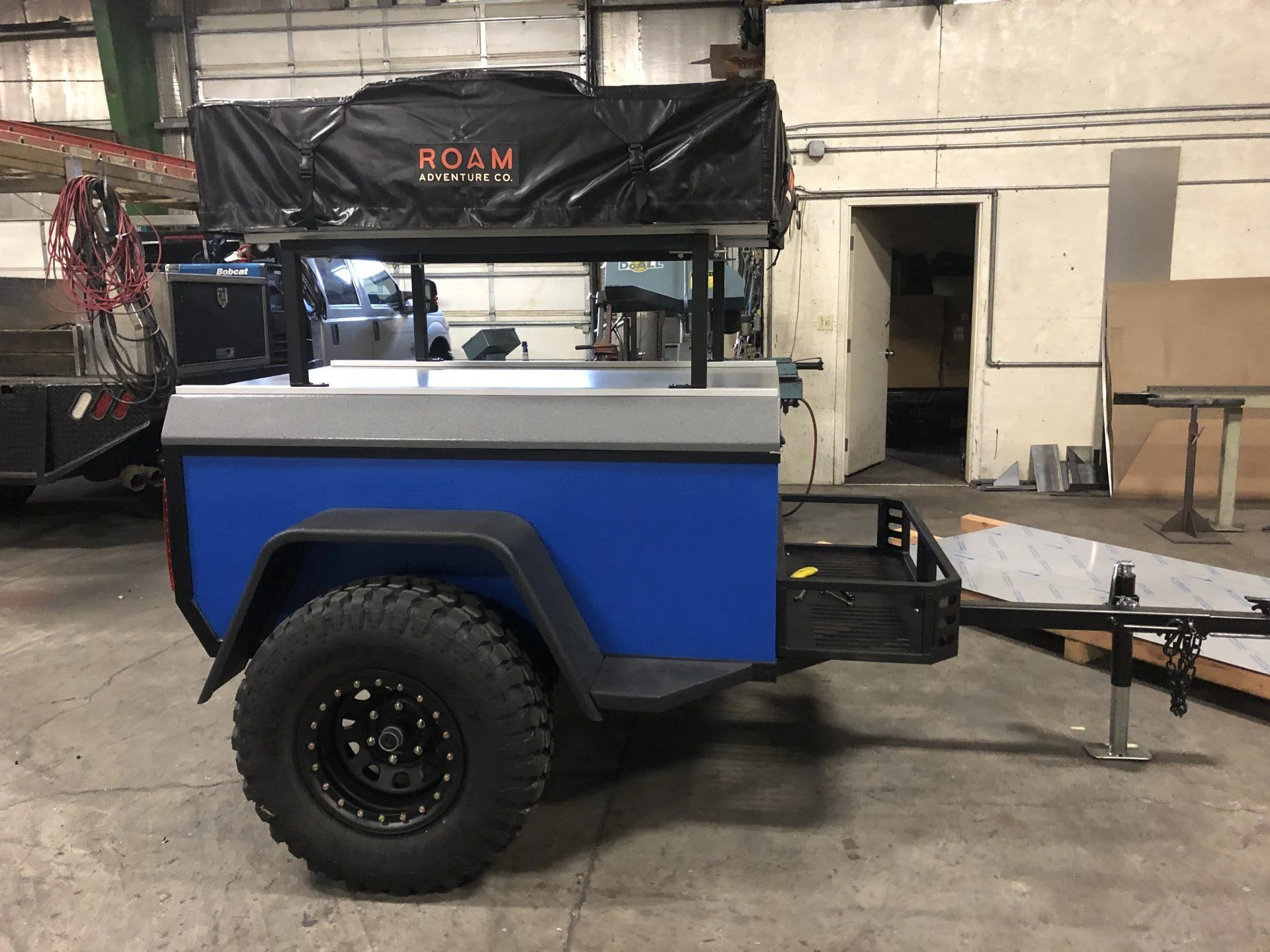

Is that 6’? Tent on top?
The image was just to show a idea you could made a lid. and when it opens has canvas/ripstop Tent sides like the pic i showed
This is the actual blue trailer you see . But the op does not want a RTT.
Yeah I get what you're angling to. Any OEM tent pop up tent system that roughly outlines the trailer, build a connection between the two.
