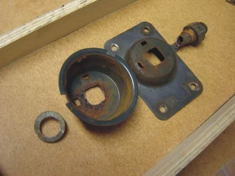

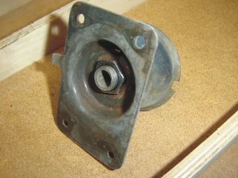

Here's the damage-

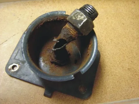

NOTE: the stalk part is upside-down to show the damage. The cup actually bolts to the front fender-
My guess it the original hollow tube was threaded, it houses the wires for the signal-

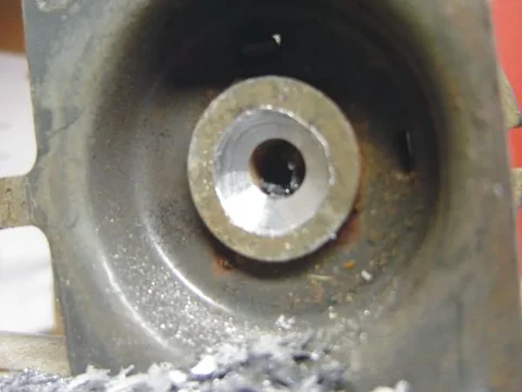

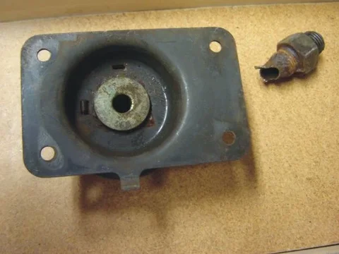

This is the view looking from inside the signal housing. The gold disk is the top of the hollow tube bolt
that connects down into the fender.
My plan was to remove the corroded hollow tube with some new similar stock,

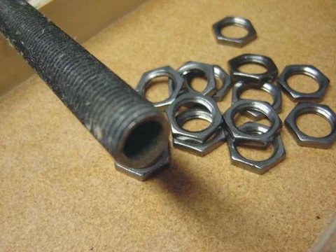

I wasn't able to acquire the exact same part in short time so I could still drive my Pig. So I improvised-
This is 1/2 inch hollow round stock from a lamp shop on Flea-Bay, the part was only a buck for 3 feet, of course the shipping was like 8 bucks (I bought lock nuts too);)
First step was to drill the head off the failed tube bolt using a 1/2 inch drill bit-

I bought lock nuts with the hollow threaded stock,

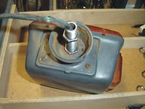

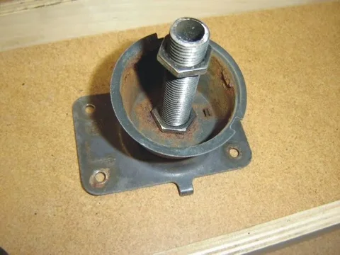

So I fastened the new part by putting a lock nut on each side of the 2 Stalk pieces (and using red thread lock)

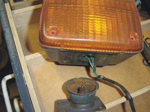

the view from inside the signal looking down,
All ready to bolt back on my Pig so I don't get busted!:doh:
(a coat of POR 15 on the internal threads might not hurt!)

That's what I had in mind for mine when it breaks. The threaded hollow tube is table lamp hardware for those who don't know.
