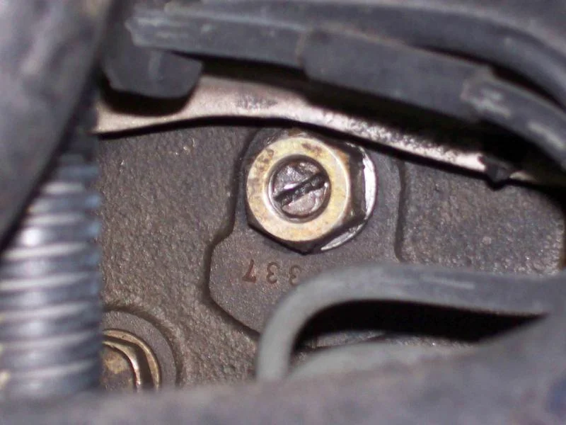

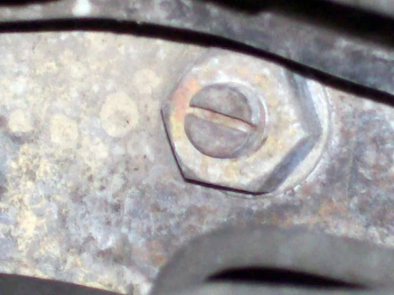

I took these pictures from the two steering boxes today. The only difference between my two cruisers is the top steering adjustment nut. The top picture is from the one with problems, the bottom picture is from the one with no problems. Maybe here is the problem. The bolt in the second picture protrudes from the nut. The first picture, the bolt is flushed with the nut. Hope someone can shed light on this.:hhmm:
