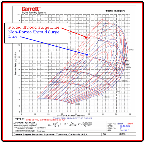

Choke Line
The choke line is on the right hand side of a compressor map and represents the flow limit. Properly sizing a turbo is important to prevent the compressor from operating past the choke line. When a turbocharger is run deep into choke, turbo speeds increase dramatically while compressor efficiency plunges (very high compressor outlet temps). Additionally, the turbo's durability is compromised by the resulting high thrust loads.

Surge Line
The surge region, located on the left-hand side of the compressor map, is an area of flow instability typically caused by compressor inducer stall. The turbo should be sized so that the engine does not operate in the surge range. When turbochargers operate in surge for long periods of time, bearing failures may occur.

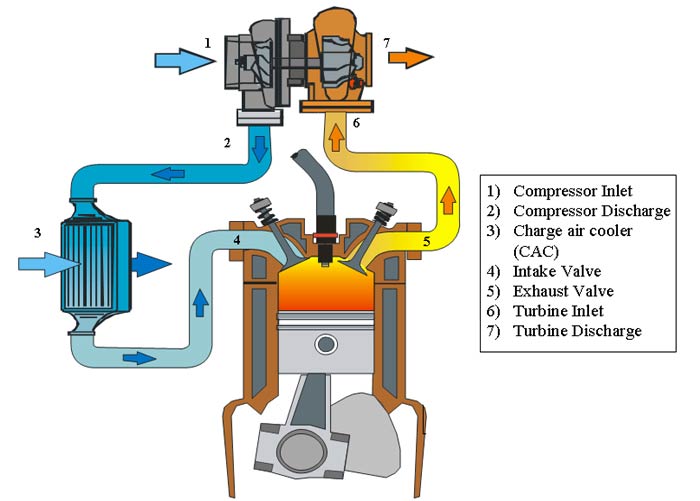

How a Turbo System Works
Engine power is proportional to the amount of air and fuel that can get into the cylinders. All things being equal, larger engines flow more air and as such will produce more power. If we want our small engine to perform like a big engine, or simply make our bigger engine produce more power, our ultimate objective is to draw more air into the cylinder. By installing a Garrett turbocharger, the power and performance of an engine can be dramatically increased.
So how does a turbocharger get more air into the engine? Let us first look at the schematic below:
The components that make up a typical turbocharger system are:
The air filter (not shown) through which ambient air passes before entering the compressor (1)
The air is then compressed which raises the air’s density (mass / unit volume) (2)
Many turbocharged engines have a charge air cooler (aka intercooler) (3) that cools the compressed air to further increase its density and to increase resistance to detonation
After passing through the intake manifold (4), the air enters the engine’s cylinders, which contain a fixed volume. Since the air is at elevated density, each cylinder can draw in an increased mass flow rate of air. Higher air mass flow rate allows a higher fuel flow rate (with similar air/fuel ratio). Combusting more fuel results in more power being produced for a given size or displacement
After the fuel is burned in the cylinder it is exhausted during the cylinder’s exhaust stroke in to the exhaust manifold (5)
The high temperature gas then continues on to the turbine (6). The turbine creates backpressure on the engine which means engine exhaust pressure is higher than atmospheric pressure
A pressure and temperature drop occurs (expansion) across the turbine (7), which harnesses the exhaust gas’ energy to provide the power necessary to drive the compressor

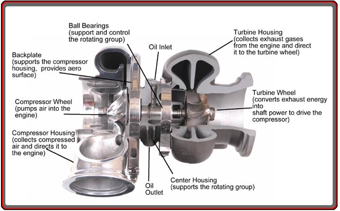

What are the components of a turbocharger?
The layout of the turbocharger in a given application is critical to a properly performing system. Intake and exhaust plumbing is often driven primarily by packaging constraints. We will explore exhaust manifolds in more detail in subsequent tutorials; however, it is important to understand the need for a compressor bypass valve (commonly referred to as a Blow-Off valve) on the intake tract and a Wastegates for the exhaust flow.

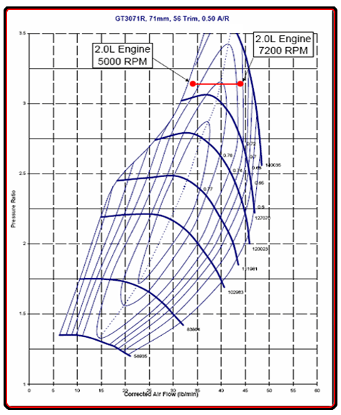

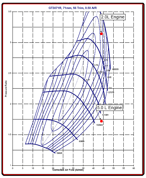

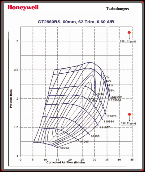

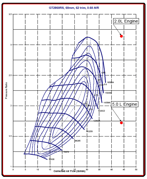

Which Turbocharger is Right for Me or more affectionately known as My Turbo & Me
Selecting the proper turbocharger for your specific application requires many inputs. With decades of collective turbocharging experience, the Garrett Performance Distributors can assist in selecting the right turbocharger for your application.
The primary input in determining which turbocharger is appropriate is to have a target horsepower in mind. This should be as realistic as possible for the application. Remember that engine power is generally proportional to air and fuel flow. Thus, once you have a target power level identified, you begin to hone in on the turbocharger size, which is highly dependent on airflow requirements.
Other important factors include the type of application. An autocross car, for example, requires rapid boost response. A smaller turbocharger or smaller turbine housing would be most suitable for this application. While this will trade off ultimate power due to increased exhaust backpressure at higher engine speeds, boost response of the small turbo will be excellent.
Alternatively, on a car dedicated to track days, peak horsepower is a higher priority than low-end torque. Plus, engine speeds tend to be consistently higher. Here, a larger turbocharger or turbine housing will provide reduced backpressure but less-immediate low-end response. This is a welcome tradeoff given the intended operating conditions.
Selecting the turbocharger for your application goes beyond “how much boost” you want to run. Defining your target power level and the primary use for the application are the first steps in enabling your Garrett Performance Distributor to select the right turbocharger for you.

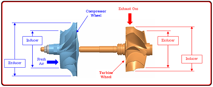

1. Wheel trim topic coverage
Trim is a common term used when talking about or describing turbochargers. For example, you may hear someone say "I have a GT2871R ' 56 Trim ' turbocharger. What is 'Trim?' Trim is a term to express the relationship between the inducer* and exducer* of both turbine and compressor wheels. More accurately, it is an area ratio.
* The inducer diameter is defined as the diameter where the air enters the wheel, whereas the exducer diameter is defined as the diameter where the air exits the wheel.
Based on aerodynamics and air entry paths, the inducer for a compressor wheel is the smaller diameter. For turbine wheels, the inducer it is the larger diameter (see Figure 1.)
Figure 1. Illustration of the inducer and exducer diameter of compressor and turbine wheels
Example #1: GT2871R turbocharger (Garrett part number 743347-2) has a compressor wheel with the below dimensions. What is the trim of the compressor wheel?
Inducer diameter = 53.1mm
Exducer diameter = 71.0mm
Example #2: GT2871R turbocharger (part # 743347-1) has a compressor wheel with an exducer diameter of 71.0mm and a trim of 48. What is the inducer diameter of the compressor wheel?
Trim = 48
The trim of a wheel, whether compressor or turbine, affects performance by shifting the airflow capacity. All other factors held constant, a higher trim wheel will flow more than a smaller trim wheel.
However, it is important to note that very often all other factors are not held constant. So just because a wheel is a larger trim does not necessarily mean that it will flow more.

◊ Surge Line
Surge is the left hand boundary of the compressor map. Operation to the left of this line represents a region of flow instability. This region is characterized by mild flutter to wildly fluctuating boost and “barking” from the compressor. Continued operation within this region can lead to premature turbo failure due to heavy thrust loading.
Surge is most commonly experienced when one of two situations exist. The first and most damaging is surge under load. It can be an indication that your compressor is too large. Surge is also commonly experienced when the throttle is quickly closed after boosting. This occurs because mass flow is drastically reduced as the throttle is closed, but the turbo is still spinning and generating boost. This immediately drives the operating point to the far left of the compressor map, right into surge.
Surge will decay once the turbo speed finally slows enough to reduce the boost and move the operating point back into the stable region. This situation is commonly addressed by using a Blow-Off Valves (BOV) or bypass valve. A BOV functions to vent intake pressure to atmosphere so that the mass flow ramps down smoothly, keeping the compressor out of surge. In the case of a recirculating bypass valve, the airflow is recirculated back to the compressor inlet.
A Ported Shroud compressor (see Fig. 2) is a feature that is incorporated into the compressor housing. It functions to move the surge line further to the left (see Fig. 3) by allowing some airflow to exit the wheel through the port to keep surge from occurring. This provides additional useable range and allows a larger compressor to be used for higher flow requirements without risking running the compressor into a dangerous surge condition. The presence of the ported shroud usually has a minor negative impact on compressor efficiency.
Fig. 2

We now have enough information to plot these operating points on the compressor map. First we will try a GT2860RS. This turbo has a 60mm, 60 trim compressor wheel.
Clearly this compressor is too small, as both points are positioned far to the right and beyond the compressor’s choke line.

So now lets look at a GT3071R, which uses a 71mm, 56 trim compressor wheel.
For the 2.0L engine, this is a much more mid-range-oriented compressor. The operating point is shifted a bit towards the choke side of the map and this provides additional surge margin. The lower engine speeds will now pass through the higher efficiency zones and give excellent performance and response.
For the 5.0L engine, the compressor is clearly too small and would not be considered.
Now that we have arrived at an acceptable compressor for the 2.0L engine, lets calculate a lower rpm point to put on the map to better get a feel for what the engine operating line will look like. We can calculate this using the following formula:
We’ll choose the engine speed at which we would expect to see peak torque, based on experience or an educated guess. In this case we’ll choose 5000rpm.
Where:
· Wa = Airflowactual (lb/min)
· MAP = Manifold Absolute Pressure (psia) =35.1 psia
· R = Gas Constant = 639.6
· Tm = Intake Manifold Temperature (degrees F) =130
· VE = Volumetric Efficiency = 0.98
· N = Engine speed (RPM) = 5000rpm
· Vd = engine displacement (Cubic Inches, convert from liters to CI by multiplying by 61, ex. 2.0 liters * 61 = 122 CI)
= 34.1 lb/min
Plotting this on the GT3071R compressor map gives the following operating points.
This gives a good representation of the operating line at that boost level, which is well suited to this map. At engine speeds lower than 5000rpm the boost pressure will be lower, and the pressure ratio would be lower, to keep the compressor out of surge.

19. What is the Inducer?
Looking at a compressor wheel, the inducer is the "minor" diameter. For a turbine wheel, the inducer is the "major" diameter. The inducer, in either case, is where flow enters the wheel.
20. What is the Exducer?
Looking at a compressor wheel, the exducer is the "major" diameter. For a turbine wheel, the exducer is the "minor" diameter. The exducer, in either case, is where flow exits the wheel.
Compressor wheel exducer diameter is incorporated into Garrett GT-series nomenclature: The "60" in the GT2860RS for example, has a 60mm compressor wheel exducer diameter.
