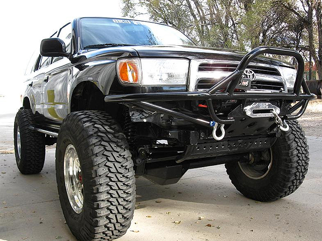

FWIW, this is my old 4runner. SAS'd, linked, heavy axles, 5.29s, supercharger, 37s, etc. Dual tcases too. It got a legit 18.5mpg hwy on several trips between Fort Collins and Colorado Springs.
