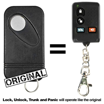

After reading this thread, I bought this eBay replacement for my '94. TVSS goes into program mode, I click the FOB.... and nothing. I tried clearing the codes as well. Rinse and repeat... still nothing. Im wondering if it's because mine is a bit older and pre-OBDII. Any sugestions would be great. My door tumblers/key copies suck and it would be great to just use the FOB.
The link you provided is to a fob that is not listing your vehicle as compatible.
Did you every have a fob. If so search eBay by the fccid number as that will get you one that works.
That is how i got one for my lx.
I did have one. A single button FOB. It was broken and subsequently lost. Where can I find that number?
Try the one I got as listed in that eBay thread. I bought two and they work perfectly on my ‘97.
After reading your post, I'm going to try programming again with a faster button response. If not, I'll order that one. Thanks

I recently purchased this one:
And I cannot for the life of me get it to pair with the car. I hold the program button down and the red light turns on, I press any button on the remote and nothing happens. Am I missing something? Which button did you press to get it to program with the car?
