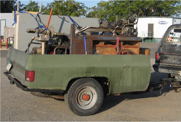

We did, but not a Chevy frame, an IH frame. Need to watch out for frames that drop under the cab as they can result in too low of the coupler. It sort of did on ours.

On ours we cut the ends off an old, square spline D60 housing and shoved the spindles into a tube making a tube axle that uses the D60 wheel hubs, bearings, & spindles. Added a fill & drain plug to the tube so now the wheel bearings run in about 3 gallons of 90wt.

Sched 80 pipe rear bumper incorporates a socket receiver hitch just for that sort of thing. Note spare on an S-10 spare tire winch.
Loaded with my grandfather's tools:
The Chevy bed didn't fit the IH frame until we made it fit. Suspect that this will be true no matter the mixture of frames and beds is. Even different generations of the same Mfg. probably don't interchange.
AFAIK all pick-up frames droop, but where they droop is the important part. Normal std height is for the top of the trailer hitch ball to be 18" off the ground. When shopping for frames you'll need to keep in mind what height your hitch is going to be and what you'd need to do with any particular frame to get the coupler to that height.
I liked using the Dana 60 full-float hubs and wheel bearings, and I'd do it again in a heartbeat, but I see no real value in using a whole truck rear axle for a trailer axle. I hear guys talk about interchangeability and having a spare diff along, but be real, I've never, ever heard of anyone ever taking the diff out of their trailer to fix their truck. Its one of those fantasies that sounds wonderful and just is not very realistic. Not to mention the added drag it creates in the trailer. Lock your front hubs & go for a drive to feel what the drag of a unloaded but driven diff feels like.
Give some thought to the tongue jack or stand. Most eventually get bent from someone forgetting to wind them up far enough, and then catching them on something. The best design I've ever seen for a tongue jack is on the tongue of the U-Haul car hauler trailers. Next trailer I build or modify is getting one of those.
