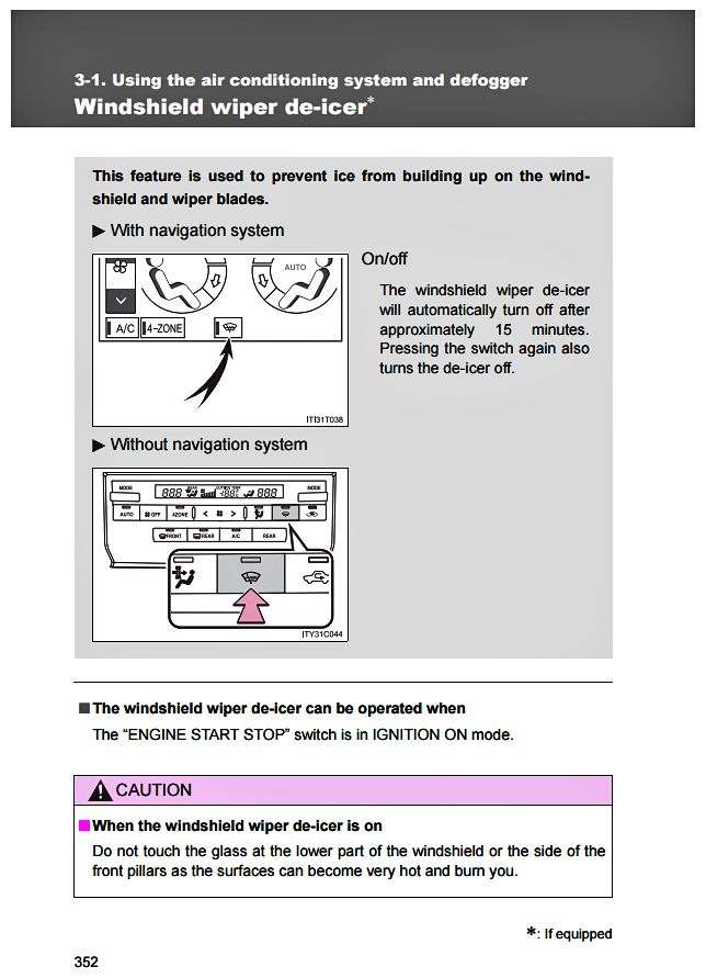

Just in case of confusion... -They only heat the glass where the wipers rest at the bottom...so they can be freed if frozen to the windshield.
And they have to be turned on using the Climate page on the NAV screen ...
Edit to add:
From the OM:

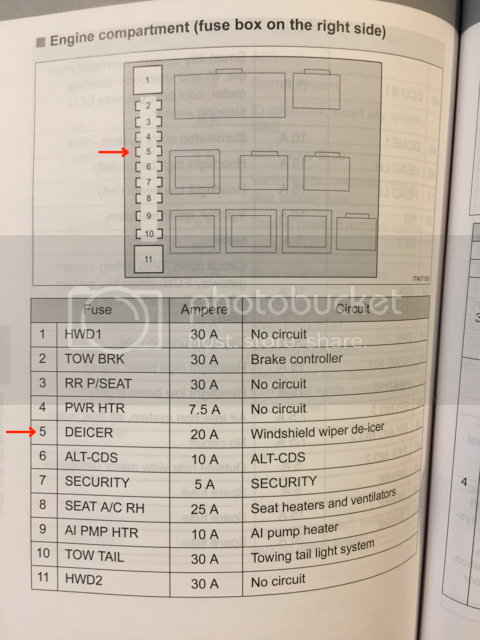

Yes, thanks guys. They worked when the car was new, but not now. Any idea what fuse runs them?
Fuse slot 8 in engine compartment box. 20A

This is my first winter with my 200 and since we've gotten a good snow in the past week, I noticed my wiper de-icer doesn't work. I checked the fuse (which is in a different location than Markuson - see attached), but that was good. I had my windshield replaced in Sept. and thought that maybe the installers forgot to plug it in. Took it by their shop and they pulled of the cowling and everything looked good. We turned the de-icer on and started feeling around the bottom of the glass under the wipers and there was no heat, except it was very hot to the touch in the small center portion of the glass where the wires come in. So, the installer thinks it's a defective glass (Pilkington) and will replace it under warranty. I'm hoping that's the problem. Does that sound right or might I have a bigger issue?
Also, one thing that I found strange was in addition to the two wires coming out of the glass connecting via plug (to power and ground) as shown in the GSIC, there were three extra wires which aren't shown on GSIC. They were all different colors and heat shrinked together, but didn't seem like they were crimped or connected (just capped off). Any idea what those are for? The owner said the previous models only had two wires. I should have take a picture, but didn't think about it.
Sounds like he's on the right track. If the glass is getting hot even if it's in one little spot then it obviously has power. The fact it's only getting hot in one spot would seem to indicate that the element is somehow shorted inside the glass.
